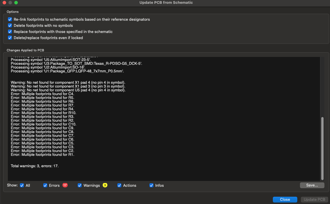

I did a re-annotate and now I got this error, multiple footprints found.
How can I get rid of the multiple footprints instead of deleting them one by one? And how is this error introduced in the first place?

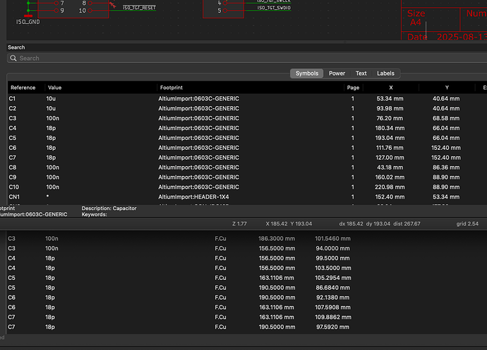

The problem is, I now have many duplicates (C3, C4, C5 etc, see screenshot). I donât know exactly what went wrong. I tried to clean up, no matter what I do (checking Re-link, tried several combinations), I cannot get rid of the duplicates!
There must be some function to fix the PCB especially if the components are linked by a unique ID.

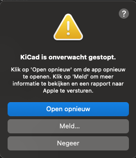

It crashed when I tried to save, second time within a few days. Attached the log file as well.

The first question is easy to answer. The second one is more difficult.

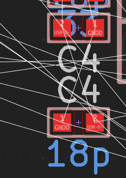

First: you are now having (in the state which you uploaded the zip file) for example two C4 capacitors in the PCB. You are trying to âRe-link footprints to schematic symbols based on their reference designatorsâ.
For KiCad this means itâs trying to ignore old UUIDs and create new UUDIDs, using for example âC4â as the link between the schematic and the PCB. Now it doesnât know what it should do with two C4 footprints. The situation is impossible to handle automatically. Because you seem to have no PCB yet, only the randomly placed footprints, the easiest way to fix this is delete everything and do the update with correct settings.
Normally the âcorrect settingsâ are without the âRe-linkâ option. That option is reserved for some special situations. See more about this in Update PCB from Schematic's match methods - #2 by eelik.
From the information you have given I can only guess an answer for the second question. You have imported from Altium something: maybe the schematic only? But you have footprint library called âAltiumImportâ, so I donât know if you have imported only the library and started the schematic from scratch in KiCad. Itâs difficult for me to follow the previous comments in this thread. The current state of the project doesnât tell how the situation emerged. If you tell all the steps which you did in order, we may be able to tell. But maybe you understand it already if you read the FAQ article.

If you used the Re-link option once, the UUIDâs get hussled around, and unchecking the checkbox does not repair the project.
I never had any issues here and used automatic matching 95% of the time.
You should not have used the Re-link option in the first place. If you had left that off, the problem would not have occurred.
