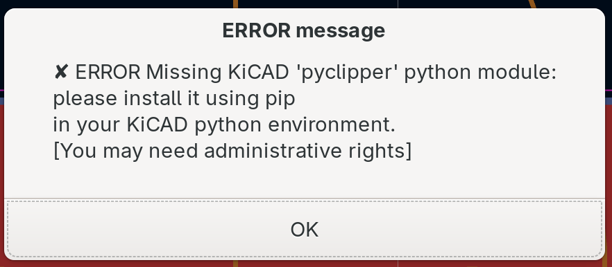

Until last week it was working. Today I get this error:
✘ ERROR Missing KiCAD 'pyclipper' python module:
please install it using pip
in your KiCAD python environment.
[You may need administrative rights]
when I try to use it:
How can I install pyclipper in the KiCAD python environment?
I found a solution:
  1. Open ā€œTools → Scripting consoleā€.
  2. Run the following commands:
    • import subprocess
    • subprocess.run(['pip','install','pyclipper'])
  3. Restart KiCad.
For anyone reading this, the other way is to open the Kicad x.x Command Prompt and use pip install in there

I can confirm that KiCad does not use the global Python environment in Linux, as I did pip install pyclipper in the global environment and did not solve it for KiCad.
According to the docs, it uses the same environment: For Add-on Developers | Developer Documentation | KiCad
On Linux, KiCad uses the first version of Python found in the user’s PATH by default.
Maybe I’m misunderstanding something though
Flatpak… :::::::::::
ah! Linux is fun I see!
