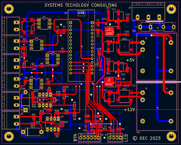

Error: missing connections between zones
This error is driving me mad. I have looked all the errors (it seems that the cross-
hair of the cursor indicate where) but I have deleted routes/tracks and re-done and same the same.

May we see a screen grab of your PCB?
A picture is worth a thousand words :slightly_smiling_face:
Two. One zoomed in and the complete PCB.
Neither show where zones have filled and not filled . . . you probably have some isolated islands that are not connected to GND even though they are on the GND net.
@Graham1904
Hotkey B will get you there.
The missed filled zones are not anywhere the error messages are…
Hotkey “B” has been done many times.
like raptor said: most probably isolated zone islands. I think it could be these:
Besides: the picture was already better than 1000 words, but an attached project archive is even better.
Pin 2 of C19 is also attached to an island. See the ratline (just above the +5V sign) in your very first screen grab.
And my picture. Ratline is single arrow. Unattached Zone is double arrow.
WOW! It is fixed. It was so hard to see even highlighted GND to see the areas floating.
