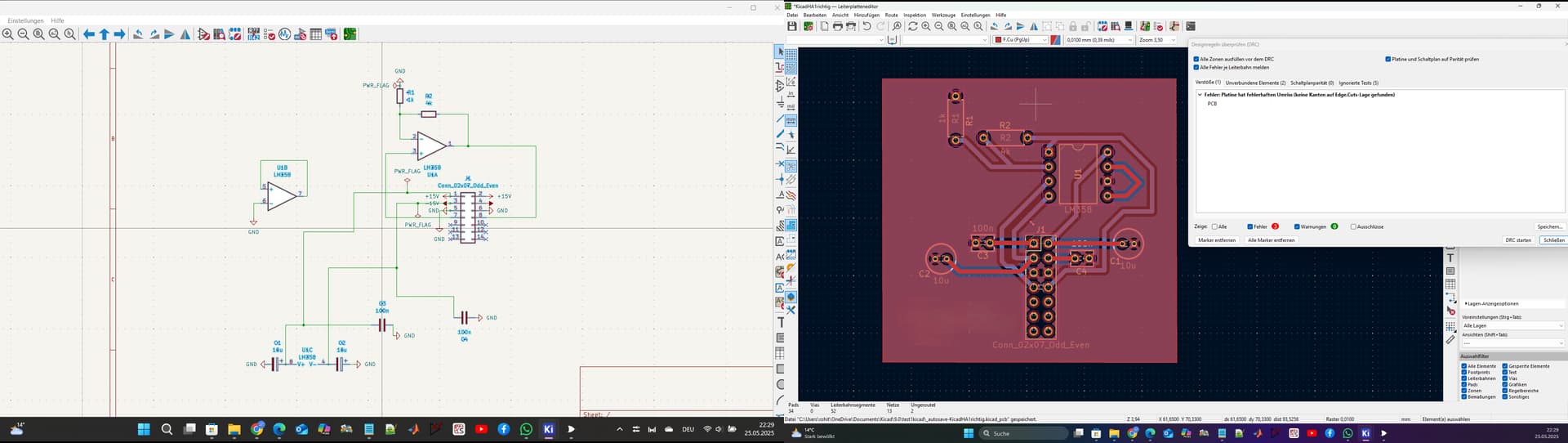

i have completed my pcb layout and started my DRC but it is showing some errors regarding missing contour.
this is my final result and error. the terms are in german.

Do you have the board outline drawn on the edges cuts layer?
i did that with the help of internet but still it is showing error. maybe i have misunderstood the edges cut layer concept. it would be very helpful if i get step by step instructions.
Can you post all your errors (and translate them into English)?

keine Kanten auf Edge.Cuts gefunden
For more info, read the manual (or a tutorial) on creating Edge.Cuts.
https://docs.kicad.org/9.0/de/pcbnew/pcbnew.html#board_outlines_edge_cuts
