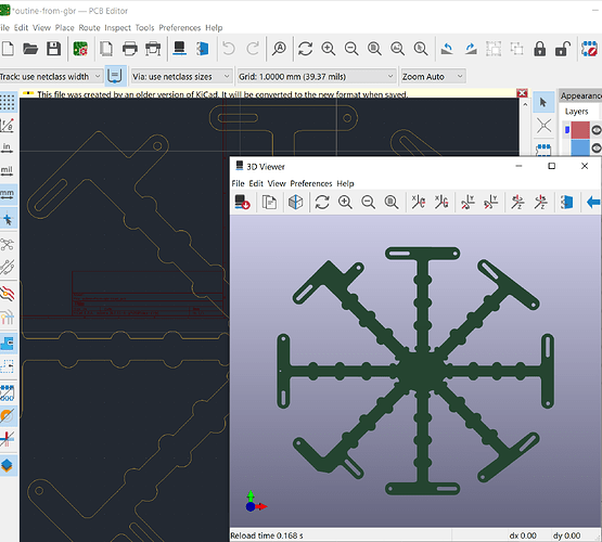

Error: Board has malformed outline (not a closed shape)
I would like to produce a 3D view of a board with a complex outline, but I get multiple errors of the type above. I have moved the end of each line segment to snap to the green node symbol on the end of the adjacent line segment and checked that the coordinates match, but still get the same error.
There are many such errors on the edge cuts shape preventing a 3D image from being produced.
Is there a reliable way of making line segments contiguous?

your file has a lot of overlapped segments…
the best IMO is to ‘clean’ the drawing with a mechanical software… i.e. FreeCAD
here a possible solution after a fast cleaning
outine-from-gbr.kicad_pcb (196.6 KB)

The SVG contains many segments which are not connected together. So the 3D-viewer and the DRC are right - it’s no continous outline.
Additional there are the 3x fiducials/passer-marks outside from the shape - these also disturb the edge.cuts algorithm.
My workflow would be:
  • import into QCAD (my preferred 2D-CAD-tool)
  • change linewidth for all items to 0.000mm
  • select all
  • draw–>polyline–>draw polyline from selection
This runs a algorithm similar to your request above (“A handy feature would be a command that closes outlines on the Edge cuts layer, joing line ends that are closer to each other than x mm”.) The result is not always 100% right, sometimes manually additional cealing is required. This shows that such an algorithm is not so simple as it looks.
At last exporting as dxf, prefereed in an older dxf-format (to avoid spline/arc problems in kicad import).

Wow, that really did the job a lot faster than I could have done it manually (if at all!).
Thanks for the work you put into that and for the useful advice for the future.
Thank you for your reply and for the alternative technique. This is useful information which will save me a lot of time and frustration.
I’ll have a play with yours and Maui’s methods.
I opened your file, exported the Edge cuts layer as svg, then imported the svg file into the Edge cuts layer of my design, but the result had no straight lines, only closed arc segments corresponding to the arcs in the original. Importing then exporting to my drawing package, CorelDraw, made no difference.
What did work for me was prompted by mf_ibfeew’s suggestion of converting to a polyline, but since CorelDraw’s version of a polyline is made up of Bezier curves, what I did instead was export the shape as an HPGL .plt file, a format which was developed originally for flatbed plotters.
Importing that file worked beautifully.
