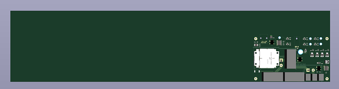

Error: Board has malformed outline (no edges found on Edge.Cuts layer)
DRC error points to a place far outside of the workspace. I have deleted all layers in that place, removed many parts thinking an attribute was assigned away from the part, redrawn the layer, updated to 7.0.5, all to no avail.
Also I redrew the board perimeter as a rectangle, separate lines, all on Edge.Cuts layer, the problem persists. The result of this error makes the 3D view look like this:
My next step if no suggestions work is to cut and paste the design into a new project file…if that works.
Thanks in advance for any ideas!
In desperation I zoomed all the way out to the -X limit at -2200 mm and still didn’t see anything, but did a select but nothing showed up, but cut everything to the left of the PCB anyway…and it cleared the error. The DRC arrow didn’t point to whatever it was, but there must have been something >1500 mm to the left of the workspace…Go figure.
