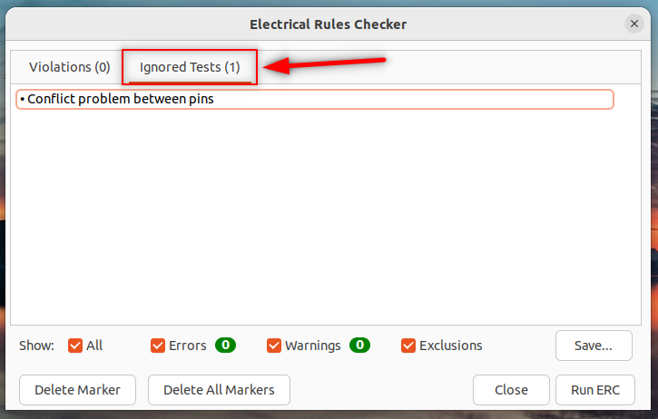

Below is an ERC output for a board I’m working on. The warnings are coming from IC’s with bidirectional digital pins which the datasheet says to tie low or high if unused (I tied them low).
For the purpose of producing a working board, these warnings can be ignored. They don’t represent true problems and the board will function just fine despite them. They occur simply because Kicad has been instructed - by way of its Pin Conflict Map - to generate a warning if pins of type “Bidirectional” are connected to pins of type “Power Output” (see below).

3. Turn off pin-conflict checks altogether. This can be accomplished a couple of ways. One is to go to File → Schematic setup →Electrical rules → Violation severity. Then change “Conflict problem between pins” to “Ignore”. A second way is to right click on one of the individual warnings in the ERC pop-up & select “Ignore all ‘Conflict problem between pins’ violations”. In either case, it changes the state of pin-conflict checking to ‘ignore’ (see screenshot below), and it will now show up in your ERC window’s ‘Ignored Tests’ tab.
If you use either of these two approaches, the warnings will go away but you once again risk missing true problems - this time because the check is no longer performed. Thus, use this approach at your own risk.
