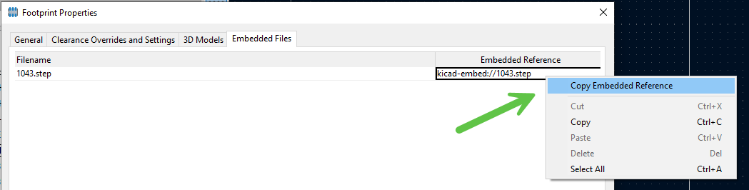

Actually, I need to save the 3D STEP file directly to my component’s footprint in the library. Otherwise, if I lose the original STEP file, I won’t be able to view the 3D model on the PCB. Is there any issue for handling this?

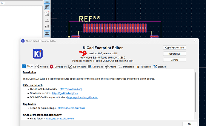

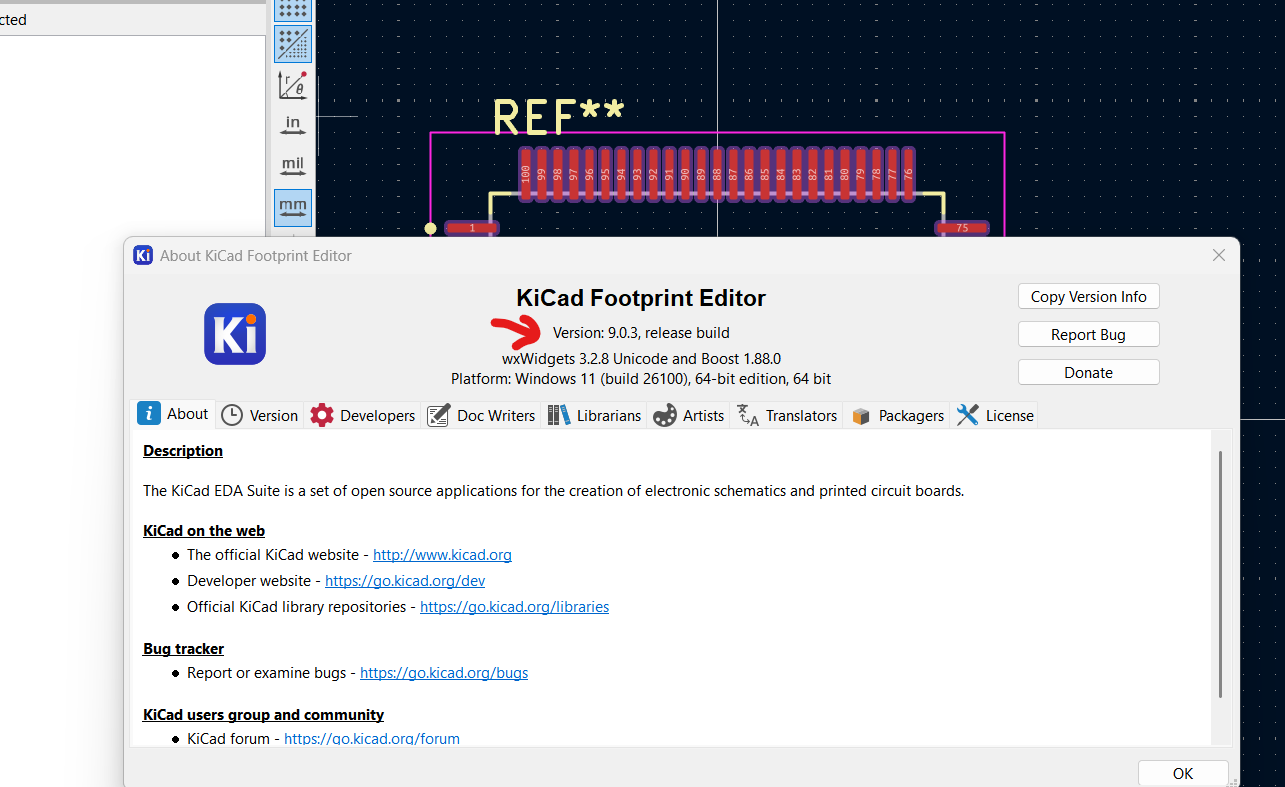

It is supported already, try 9.0.3

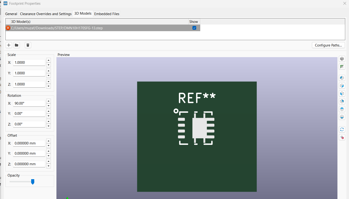

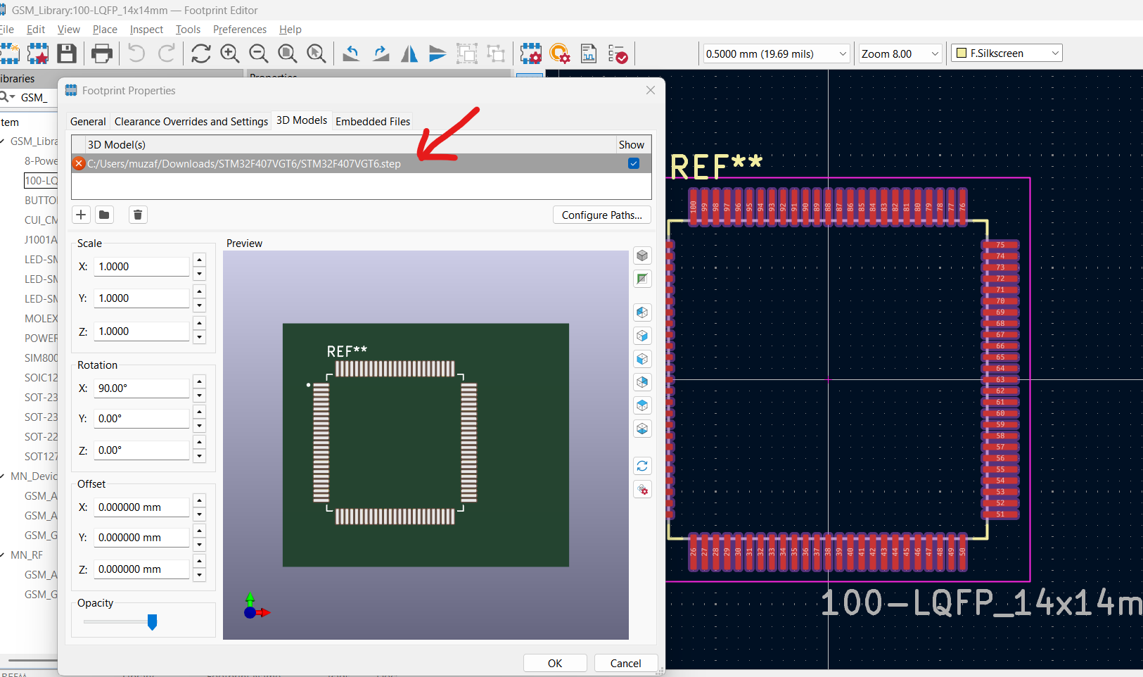

I am using v9.03. When i deleted 3d step file, it doesn’t show step file on footprint.
You need to use the option to embed the step file when you add it to the footprint

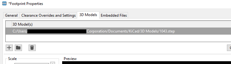

Yes, where is that option? (I might be blind, but I can’t see it yet.)
This?
Yes. Looks like you figured it out?

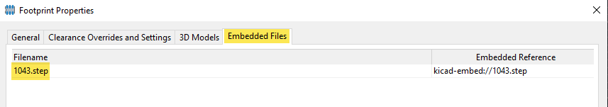

I guess I’m still confused as to how to tell the footprint to use that vs looking at a folder on the PC
You can paste the “embedded reference” from the other tab into the 3D model path.
There is also a checkbox for “embed model” when choosing a model in that tab, that can do this in one step.
Wow. Thank you. I wish there was a way to make these less hidden. I feel like someone just handed me a secret map. Thanks again!
