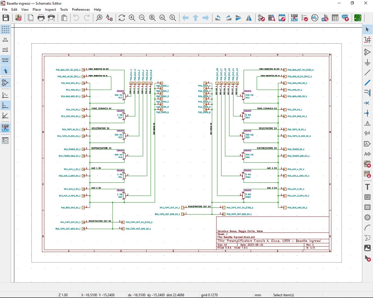

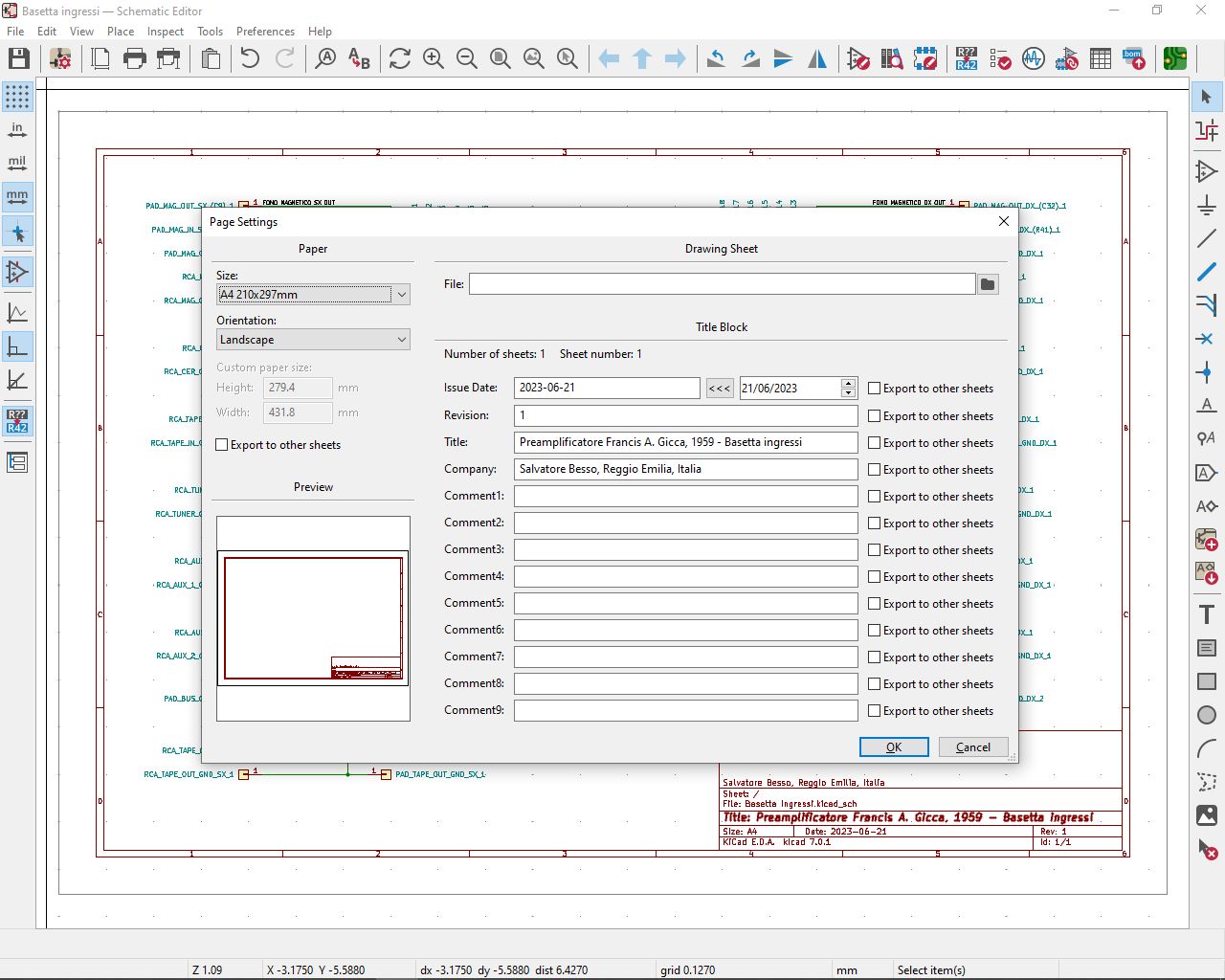

I have found a strange problem (very small indeed) and I’m not sure if it’s worth to open an issue on bugtracker. I briefly describe it below:
After the Cancel operation the schematic shrinks. I tried to not move the cross-hair cursor when I took the screeshots. Notice that clicking OK instead of Cancel doesn’t trigger the problem.
I’m using KiCad 7.0.1.

I just tested in my system and it is still the same but once you click OK, it doesn’t happen anymore, however if you close the schematic and open it again, it goes back to the same behavior.

thank you for your replies. I have something new to add. The example that I have reported concerned projects using an A4 page size. I have opened few minutes ago a project using an A3 page size and the problem is opposite. After ESC or Cancel the schematic becomes larger instead of shrinking.

ok, I have investigated further and problem doesn’t depend on page size, but on zoom level. I have opened an issue here:

It is close because it is fixed in the coming v8, apparently it is not possible to fix it in the current v7 because there are some issues with “the strings” :slight_smile:

The zoom issue is now fixed in 7.99 (Master)
