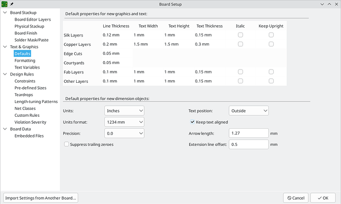

Try manually changing the values ​​circled in red first, then use the buttons to toggle between bold and normal, and you’ll see the difference.
memo:
Configuring default text and graphic settings
ps.
It seems that the following definition is also provided internally for the bold text.
Normal text is normally around 15% the fontsize, and bold text around 20%. So we set a hard limit at 25%, and a secondary limit for non-decorative text that must be readable at small sizes at 18%.
