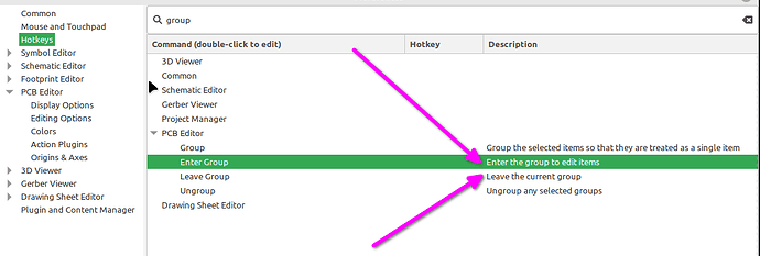

Select the group–>RMB-click–>context menu–>Enter group
(not sure with kicad v6, but v7 + v7.99 provide this option)

The others beat me, but any way:
Easiest if you set up hotkeys.
Enter the group which allows you to to enter the group to make alterations, then when those alterations are complete, Leave the group, which means you leave the group still there and intact, with your alterations.
When you are tired and bored with that group, ungroup removes the group.
