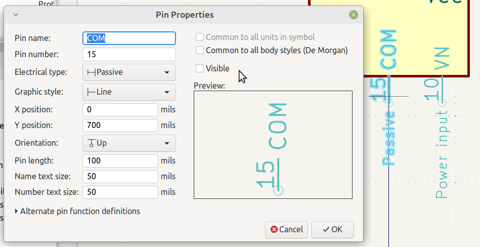

The issue I have right now appears to be the greyed out image of a previous pin location causing the duplicate pin error.
The grey image cannot be deleted or moved?
In the screenshot from the symbol editor below, both the COM (pin 15) and VN (pin 10) have their visibility disabled. For me, these pins are not gray, but cyan.
They can also still be edited just like any other pin. I’ve never seen “ghosts” of previous pins or pin locations.
You can also use: Symbol Editor / Edit / Pin Table to see an overview of all pins in a spreadsheet. You can click on a column header to sort them from that column. Sorting on pin number quickly reveals duplicate pin numbers.
You can also use Symbol Editor / Inspect / Symbol Checker to examine problems with schematic symbols.
If I move the pin the blue version moves with it, and it leaves a fade grey pin underneath with a different pin # , probably the original ?
Sounds like a hidden pin to me.
No. It is called Pin Stacking. KiCad uses this technique to be able to connect one wire in the schematic to multiple pins on the IC. (Most often this is a bunch of GND or power pins). I don’t really like this technique, but it’s fairly common in KiCad’s default libraries.

All pins should be visible (even when stacked) in the symbol editor.
Did you do anything with the pin table?
I get this but all pins appear correct?
I still have a greyed image of a pin I don’t seem to be able to get rid of?
This greyed-out pin cannot be moved or erased etc.?
Pin table
Have you tried a long click to select it?
This brings up a context menu which shows all things at the cursor location.
You’ve mentioned quite a lot of times you can’t select it, but not what happens when you attempt to select it.
Maybe it helps if you set the pin to visible and make it longer in the pin table.
The pin was moved to another location and apparently left this greyed image behind?
Selecting it brings up the highlighted editing outline of the whole IC FP.?
