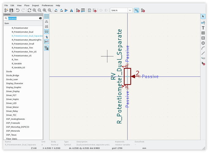

I can not seem to find a dual pot symbol / footprint that allows you to split its two halves… much like can be done with a dual opamp. In my schematic the two halves are operating some distance apart… and it looks rather untidy (and difficult to read) as a result.
Thanks for any advice.

Hmm, only took me a few moments to find this in the standard symbol library:
It has A and B units.
Footprints are more varied so I’ll leave that to you. Maybe 2 rows of 3 pads.

Ah!!! I spent some time looking for that. Just gotta look in the right place!
Footprint is already done. Thanks
