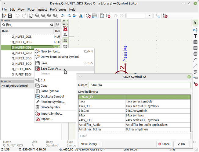

  1. Make sure you have a personal library. KiCad’s own libraries are read-only, because they are a part of KiCad itself and can be overwritten during KiCad updates.
  2. Open a Jfet in the Symbol Editor. At this stage the only important part is the symbol graphics. The Q_NJFET_GDS that jmk mentioned is indeed just fine for this.
  3. Right click on the Jfet. then Save Copy As.
  4. In the Save Symbol As dialog, select your personal library (00aa_lib in the screenshot) and enter the LSK489A name, and then press the OK button.

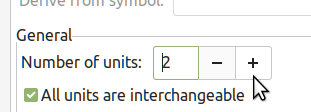

  5. In the Symbol Editor / File / Symbol Properties dialog, set the General / Number of units to 2.
  6. You can also directly set the Footprint link in that same dialog.
  7. By default the All units are interchangeable checkbox is on, and this is good in this case. It keeps the graphics of both units in your symbol the same.
