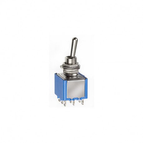

I am open to other components, as long as they fulfil the 3 position (On-Off-On) Double Pole requirement.
Here is the type of switch I had in mind: https://www.amazon.nl/gp/product/B08KZW2L9S/ref=ox_sc_act_title_1?smid=A327GUZ5FBQX9V&psc=1
switch
The ā€˜3 position’ is not really too relevant. The only difference would be the symbol could possible be drawn in an off position. There is not enough information on the part there for a footprint but it should be easy enough to make your own. It is an essential skill so check the FAQ. I’m pretty sure there is a tutorial in there for this. Without an actual datasheet you may have to buy the part and measure it. No pin width is given and the distance between pins looks like it is ā€˜outside to outside’ which is probably wrong. Chances are that is a ā€˜center’. Still, pin width is missing.

This description is not of an ā€œOn-Off-Onā€ switch which would be a nPDT switch with a center off position. This description would be a nP3T switch and could be described as an ā€œOn-On-Onā€ switch. The DP3T switch in the schematic has 8 pins (they are numbered), and the picture of the switch that you provided above only has 6 pins making it a DPDT switch.
So, what exactly are you looking for? DPDT with a center off position, or DP3T?

The image that you link would normally be chassis mounted and connected by flying leads or an on board connector, so you can represent it in the schematic as a switch and on the board by a connector or series of solder pads.
DPDT/On-Off-On is the switch photo you posted.
I use SPDT/On-Off-On and your Schematic looks like this is what you want (looks like you’re not using the other two On posts (but difficult to see clearily). If SPDT will work for you, a Step model and .MOD file are attached…

My mistake with the above component. I have now found the actual component I want.
I need a DP3T On-On-On switch.
Component: https://www.digikey.com/en/products/detail/nkk-switches/M2044SS1W03/1027467
Datasheet: https://www.nkkswitches.com/pdf/MtogglesBushing.pdf
The symbol is already available in KiCad. It is just the footprint I need. I understand it is possible to create it, but I figure somebody has used this component before.
This is a strange one because the schematic symbol has 8 pins but the footprint has 12 pins. Is that possible to accommodate using the existing symbol?

Yeah, their nP3T switches are odd. There are 12 pins and you will need to provide traces on the board connecting two pairs of pins. See this screenshot from the datasheet that I’ve annotated for you:
As shown, you will want to connect pin 3 to pin 5 and pin 9 to pin 11 external to the switch with traces on the board. In use it will be:
           |      switch A       |      switch B        |
(3) Up     | 2(pole) to 1(throw) | 8(pole) to 7(throw)  |
(2) Center | 2(pole) to 4(throw) | 8(pole) to 10(throw) |
(1) Down   | 2(pole) to 6(throw) | 8(pole) to 12(throw) |
I would probably draw this symbol as a 3 or 4 unit symbol. Units A and B will be the actual functioning switch based on the above table, and Unit C (and Unit D if going for a 4 Unit symbol) will be the pins that need to be shorted together for proper operation. Then I can stick Unit C (and D if used) in a corner of the schematic with wires connecting the proper pins and a text note explaining what it is and keep that functionally necessary clutter out of my schematic logic.
