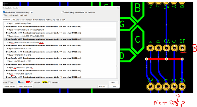

Hello All,
I recently created some custom octagon shaped pads. When I ran the DRC check it reports the annular ring size as zero, thus causing errors. I searched the forums and thoroughly searched the documentation and could not find a resolution. I used the “edit pad as graphic shape” tool as you can see from the pics. The pads look fine and I have no issues with connecting tracks to them. Any ideas?

Ok, so you guys can see the pic, right? See the octagon shaped pad, right? See that it has an annular ring, right? The width of the annular is roughly 22mils. The DRC reports that’s it 0. I have created a dumby project. Funny thing, the small footprint for a diode with the octagon pads does not report an error.

I can see the picture (PDF) but as far as I can tell, the DRC errors do not relate to the footprints shown . . . so it’s not possible to help from that picture.
Your demo project is supposed to show the actual error you are getting. Without that, it’s only of limited use. But I did load your footprint in the footprint editor, and I see you made the pads by combining a circular pad and a graphic octagon to make your pads.
So I guess that the problem starts if the hole in the circular pad is too big, compared to the diameter of the pad itself.
But why such complicated pads? It’s simpler to just use a “Chamfered rectangle”. I guessed the chamfer width at 28%, if you want to be more accurate you can apply some geometry.

You are correct. I was just playing around with the pad edit features and then the errors showed up. I was just curious why the software was reporting no annular ring when there clearly is one. And it doesn’t do it all the time.
