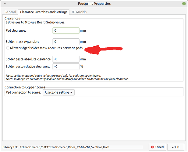

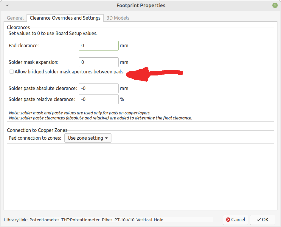

There are different ways to set solder mask expansion (and clearance) overrides. You can set them on a footprint basis, but also for single pads, and when an “override” is set to zero, it’s inherited from another level. I just noticed the checkbox below in the Footprint properties. Looks like this is very close to what you want.
Note that this checkbox is not present for the Pad Properties, but only for the Footprint Properties:
Applying the “Allow bridged solder mask apertures between pads” check into the footprint Properties does do the trick.

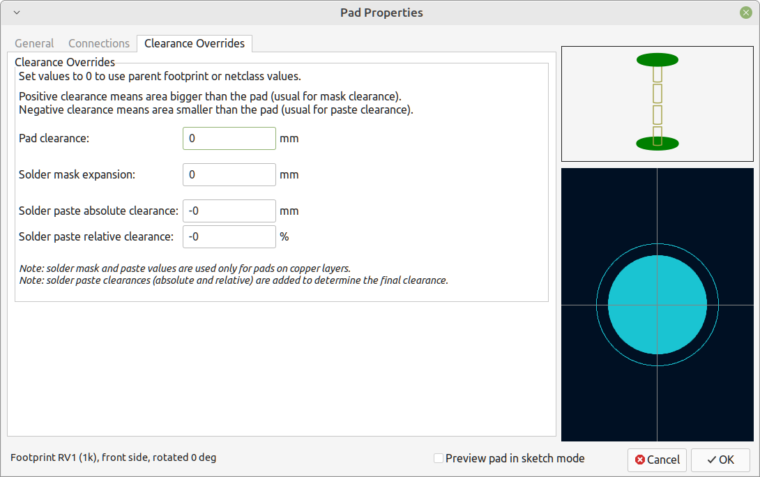

Good for you it works. I am guessing it would also work if you set the Solder mask expansion for either the pad or the whole footprint to a very small (maybe even negative) value.

I also thought some more about that. (And experimented a bit). I guess it’s nice if you can create a solder mask aperture for a NPTH. This prevents pinching of the solder mask when used as a mounting hole, when lock washers are used, small pieces of the solder mask may crumble if pinched. It would be silly if you would have to place an aperture pad over an NPTH just because you want to remove solder mask (regardless of why you would want to do that) Solder mask clearance is standard part of a pad (and NPTH) so it’s logical to just use it.

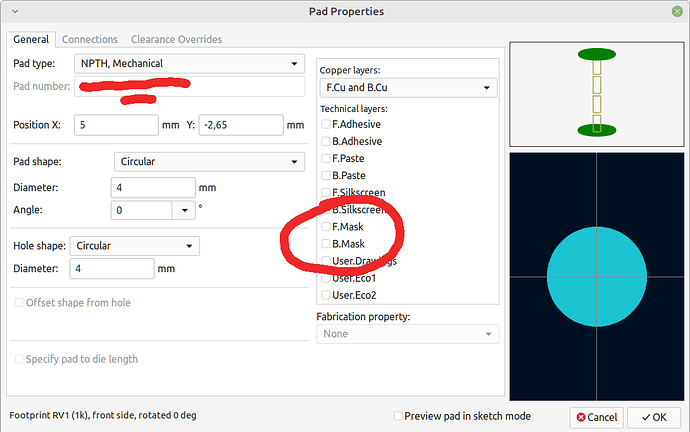

But I do think I found a bug:
When you edit a NPTH in the Footprint Editor, you can turn off the solder mask layers:
And when the solder mask layers are turned off, solder mask expansion is still applied in the footprint on the PCB. (At least, that is how my KiCad V8.0.9 behaves).
