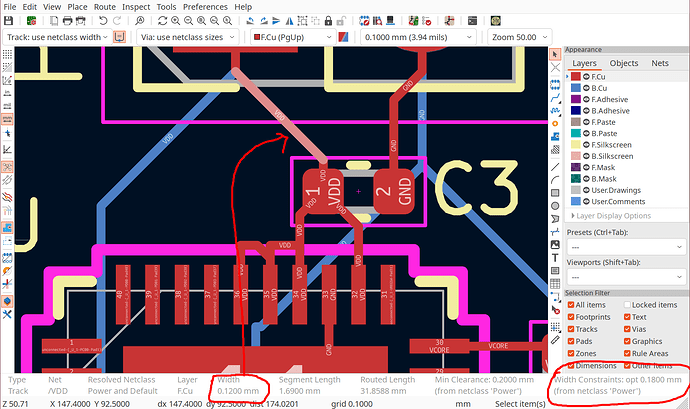

I have some traces that are too narrow:

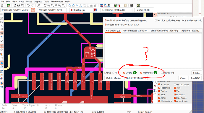

However DRC does not catch these violations:
I tried it many times. How can I configure DRC to catch basic violations like trace width?
I am using KiCad 9.0.1 on Ubuntu 24.04.1 LTS on x86.

First: thanks for mentioning the kicad version.
regarding your issue: your first picture shows actual width (left red circle) and optimum width (right red circle), but not the minimum required track width.
You have probably set the **minimum** width for netclass power to a value smaller than 0,12mm.
possible places to set/influence the minimum width:
You could check with: select the track –> Inspect–>Check Constraints resolution which source is responsible for the trackwidth.
