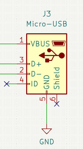

I have this setup with the USB connector having the Shield pin 6 with the not connected flag.

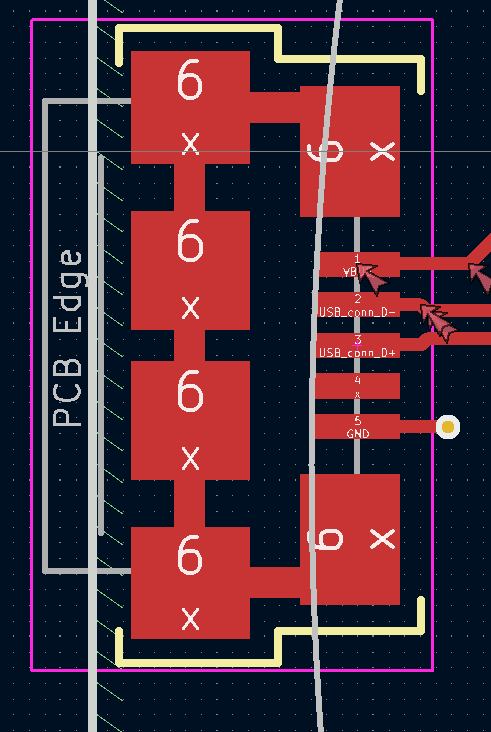

However, the footprint in use has multiple pads assigned to pin 6 as shown here:
But then the DRC complains about it. However, the schematic says they should not be connected.
Is this a bug or some sort of really important and required check?

for my clarification: I don’t see the ratsnest lines between the pads nr.6. ratsnest turned off?
In general this was the old v6/v7 (and maybe older) behaviour.
For v8 there was a gitlab issue which has changed the behaviour: Do not mark multiple no-connect pads of the same name as requiring connection (#15692) · Issues · KiCad / KiCad Source Code / kicad · GitLab.
The picture I shared is the footprint from the footprint editor, this one if from the layout, see.
