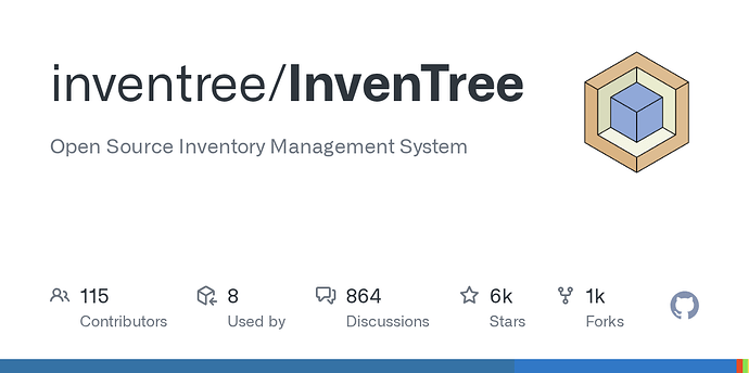

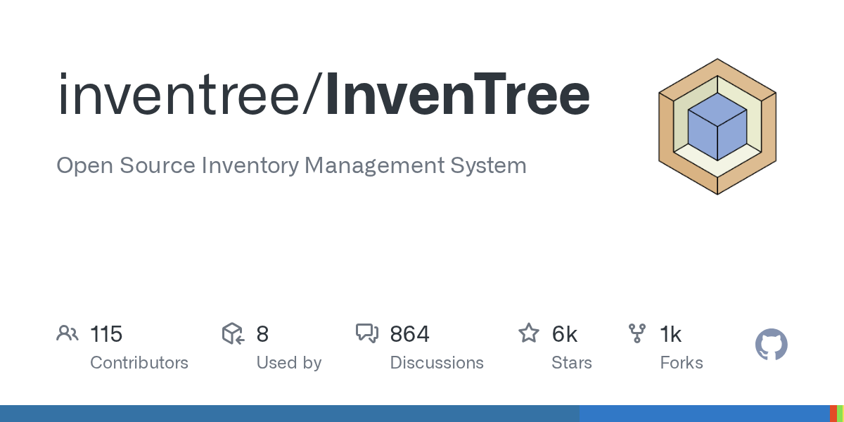

An other interesting option, that seems to be well structured, is InvenTree by @SchrodingersGat
