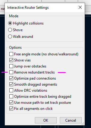

Hi. When laying traces for a ground connection that should go on both sides of my PCB for heaviest connectivity, it seems that whatever side I lay, the opposite side disappears automatically. Here’s a video showing this in action: https://youtu.be/45jU3eLQXOc
Any ideas why this might be happening? I shut down and rebooted in case it was a glitch, but it is still happening. Perhaps this is a setting or some conflict? Strange that the trace just disappears without prompting me or giving me some other error though.

TL;DS: There’s a setting for the track router that deletes duplicate tracks. Unset it.
There sure is . . .
Oh, amazing, thank you both for telling me (and showing me) this option!
