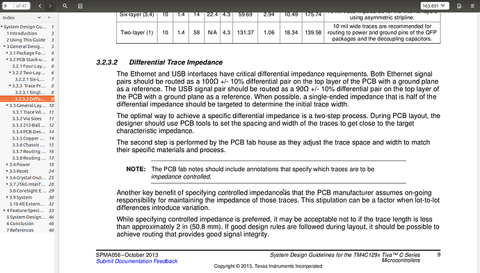

In my controller data sheet, they had mentioned that for 4 layer board Width is 12 mil (0.3048 mm) and gap is 24mil (0.6096mm) and also they mentioned not less than 2 inch(50.8mm) track length. but when i routing the differential pair, controller pad cannot able to accept the size, i am using arm based controller. For your kind information controller has 120Mhz normal frequency

In that image they had mentioned that for 100ohm +/- 10% impedance is ethernet and 90ohm +/- 10% impedance is USB. Kindly help me to complete the differential pair routing

  3. For inner layer to signal layer gap will be 0.2032mm. If you have doubt kindly verify my attachment in previous
That is the recommended stack-up from the datasheet, not the one provided by your manufacturer?
Just in case you where not aware, unless they specify it, you may end up with just about any stack-up to suit the one customer who paid for a certain stack-up that you end up sharing a panel with.
