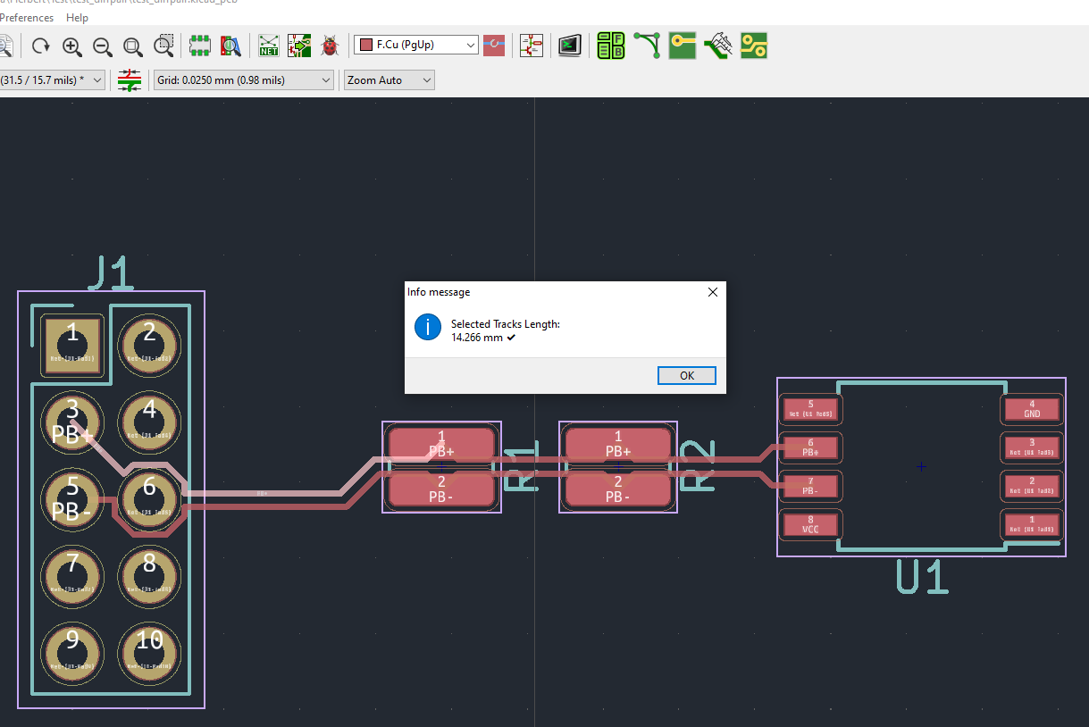

I am trying to route a very simple differential pair. I named the nets with +/- respectively and i can start routing but Kicad won’t let me finish the connection. Either the differential pair disappears completely when i hover over the pad where it should connect or it draws the signal through the pad where it should connect to.
See picture
https://ibb.co/0jJMf2D
Version is Kicad 5.1.6 on Windows 10.
Any ideas what’s the issue here?

I often get such situations, I assumed that the pads are to far away from each other to be routed properly, my work around is to stop before reaching the final pads and then route the individual signals. Sometime it helps also to route in the opposite direction (in your case, from the THT to the SMD)
Of course, check your clearances and track widths to see if the track is at all routable.
Thanks for your reply. Clearances were OK. I also tried from the other side but very similar result. Even tried from both sides and then connect them in the middle but also similar behavior.
I managed to finally get the traces routed now by randomly going up and down a little and then shortening the traces but is the differential routing really that glitchy in Kicad?

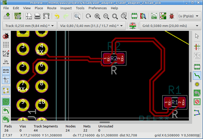

I had never routed a differential pair before, so I made a little test myself, and I made this:
On the first try I had some trouble connecting to the THT connector, and then I discovered you need to add at least one intermediate fixation point after you start the differential track before you connect to the end.
When I did that, both ends of the pair got connected as expected.
I do find it a bit disappointing that if you drag one of the tracks of a differential pair, the Interactive Router treats them as separate traces and the coupling is lost:
Because I already made a test case, I thought I might as well share the projgect:
asdf_adapter_2020-06-03.zip (6.2 KB)

I did a bit of experimentation, you can only match the lenght of the segment:
Here you can see the length of the complete signal:
and here the length of the last segment:
When matching the length, it is shown the length of the last segment:
