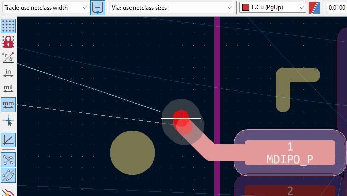

I’m trying to route the Ethernet differential pair MDIP0_P/MDIP0_N in KiCad v8, but it’s not being recognized as a differential pair during routing
schematics
net class assignments
Any guidance on how to resolve this would be greatly appreciated

Silly thing to check, are you attempting to route with Route Differential Pair? It appears you may be just routing one of the nets using the normal route tool (default hotkey X), but the differential route tool is separate (default hotkey 6, i believe?)
