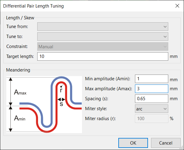

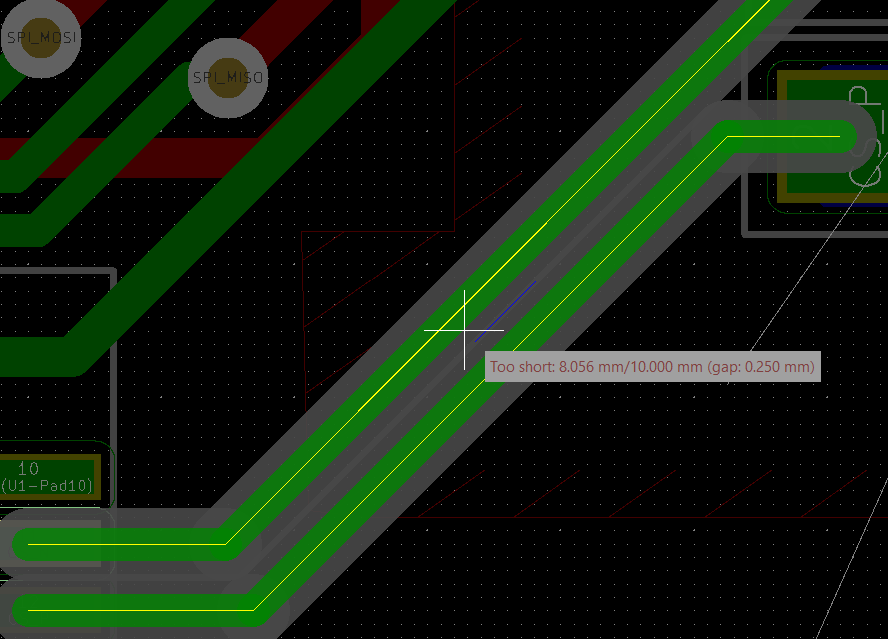

I am using KiCAD 5.1.6 and having some trouble tuning the length of the differential pair. It just did not change anything. I wonder if I did the wrong setting?
Any enlightenment would be appreciated, thanks!

you have to click where you want the beginning of the mitters (wavy tracks) and slide to one side or the other, try maybe to use a bigger target length to get an idea how does it work.
