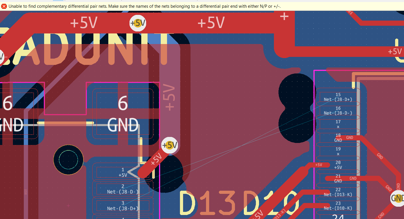

Hi there,
This is my first attempt at doing differential routing.
Basically I understand that the pins shld be named with being formatted as either SIGNAL_P/N or SIGNAL+/-. I have done such as for schematic, keeping it simple and naming it D+/- for both sides.
However even after the same naming at both upstream and downstream, I am still getting this error.
I have tried playing around with the naming, and begin routing at both sides, however error still exists. Is there anything that I have missed?
Looks like you’ve named the pin, not the net itself. I believe the differential naming system requires actual labels (normally local labels but could be any type) that end in P/N or +/-.
Ahhh I see, it works now.
