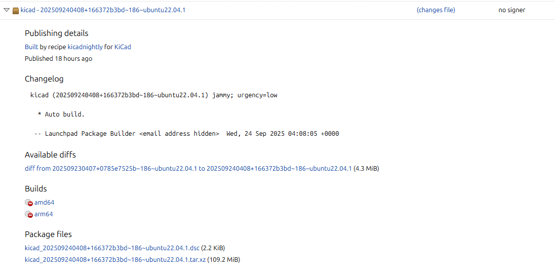

Are we having some issues on compilation distributions? In particular with Ubuntu 22.04, since the compilation is dated as 04-Sep-2025.
Compiling KiCad on older LTS versions gets into many dependency problems.
If you are experimenting with bleeding edge Nightlies, why stick to 22.04?
The Ubuntu 22.04 is my working computer. I can not upgrade the OS.

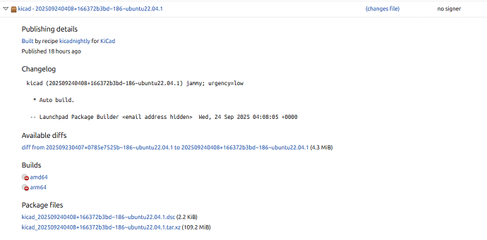

Am I checking the wrong release page? In this, appear the 22.04 had a release:
Launchpad is basically abandoned by Canonical even though it’s the only way to deploy packages. What you are seeing is the broken UI (thats been like this for more than a decade)
What you have to do on that page is click this link on the side:
And then it’ll show you the real package status
And find the right package and expand it to see builds failing
The 22.04 build should be fixed tomorrow.
