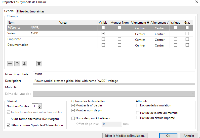

my problem is that i created different GND and different VDD like AGDN, AVDD, DGND.
But when I test with the “Highlight Net” they are all connected as you can see in the image below.
I use kicad 7.0.7, release build
Thank you for any help you can give me,
Basil
Have you used net ties to connect them together?
If you used a simple wire in the schematics editor, it’s normal that KiCad would consider them one net.
How did you create those additonal GNDs? By taking GND and editing the label? That’s a common trap. You have also to change the label on the pin inside.
There is no AGND symbol in KiCad’s default libraries.
What is the origin of these symbols? Did you make them yourself?
KiCad’s power symbols are still a bit of a kludge. They act as global labels, but name of the net is not derived from the symbol name, but from the name of the pin in the symbol, and that name is also hidden in the schematic. In the screenshot above it is the cyan text, and not the green text at the bottom of the symbol.
If this is the cause of your trouble, then you have to modify these symbols yourself in the symbol editor, and replace the symbols in the schematic with the updated versions.

Hello, thank you for your reply
as you said, I didn’t name the pin and I didn’t assign it a number, like the ones in cyan text on your image.
that’s why all the different GND and VDD I’ve created are connected together
It was a bit stupid of me
Not really.
It is is not very logical to do things this way in KiCad. It has been fixed in the nightlies, and in KiCad V8 (Expected February 2024) power symbols are implemented in a different way and you can just change a text string in the schematic to use it for a different net.
