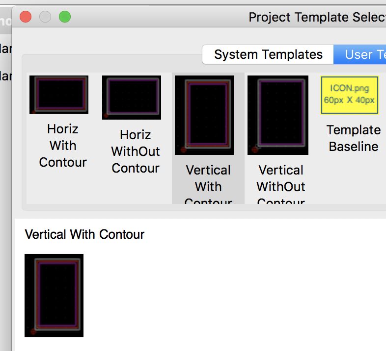

KiCad has project templates. You can create a project, set the project settings and save it to the template folder.
Then you can start a new project by using New -> Project from Template.
I haven’t used templates myself so YMMV.
eelik is correct.
I have several temaplates - each with a different Icon and preview - they appear in the new project from Template panel).
Example:

I could always reflect that back on you. What @BlackCoffee seems to be describing is a template that is just your preferred defaults (including a custom worksheet file). So when starting a new project instead of selecting “New/Project…” and then modifying the OEM defaults, you select “New/Project from Template…” and select the template that you’ve already set up with YOUR defaults.
@SembazuruCDE Bingo! Exactly:
Using the Layout tool, I hacked up the default to suit me and saved it as mySchematic Template. I created a new PCB with my pref’s/etc and saved it as my Base…etc template. Added the Icon/Meta stuff and placed them into myTemplates folder…
A clarification: Though I saved the first as mySchematic… It’s just a template Worksheet used by Both the Schematic and the PCB’s sheet. Probably should rename them…
