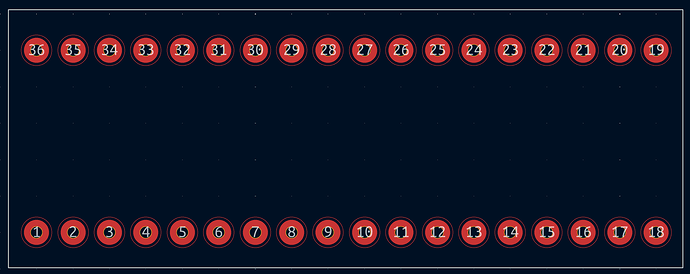

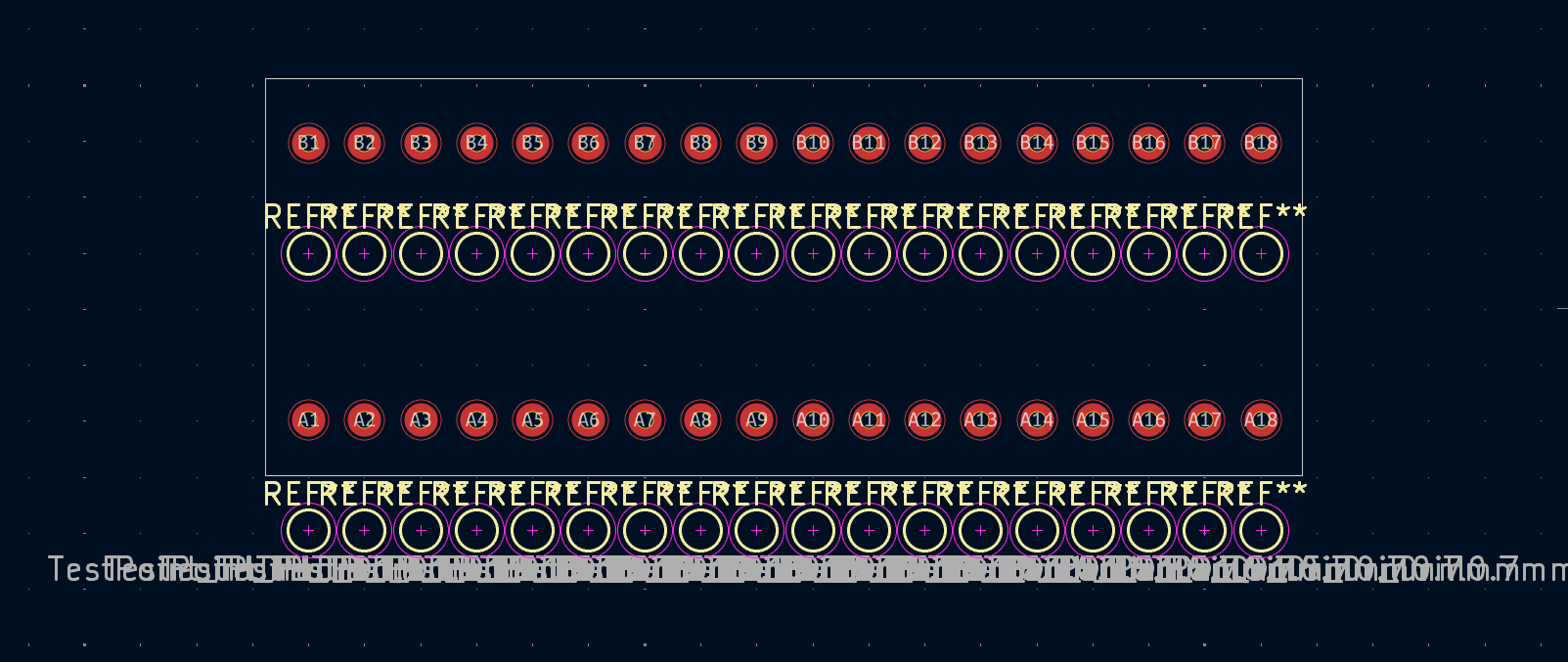

I’m trying to create a PCB that allows me to attach SMDs and have their connections routed to pins of my choosing so that I can, in essence, attach several SMDs to a breadboard via the “adaptor” I’m creating.
I’ve decided on the board dimensions and laid out 36x 1.5mm pads with 0.7mm holes per the attached screenshot. The bits labelled A1-A18 & B1-B18 are what I’m wanting to see, but I’m also getting a plethora of “REF” labels and the yellow/purple symbols with a “+” in the middle - in addition to the “Test_Point” label at the bottom.
All of the extra stuff is making a mess of the board.
Can they be turned off? Am I on the right track here, or am I approaching this in a bad way?
All I’m wanting to do is add a bunch of SMD pads & route them to the holes I’ve created. I’ll solder a couple of header strips from there.

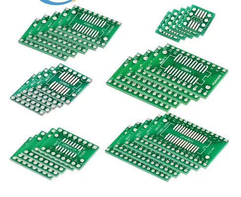

Not an answer to your question, but have you ever seen these:

  1. In the layers panel, only 1 layer appears to be selectable at a time - which is Front Copper.
  2. I went into that area and unticked the only thing that seemed relevant (Visible, Fields only) but it didn’t make any difference. Am I missing something?

I did wonder if something like that existed, but I don’t think it would help me anyway as I want to make up something that’ll support several parts at once (typical laptop VRM components) - so I hope to get a MOSFET, inductor, and a capacitor on at a bare minimum.

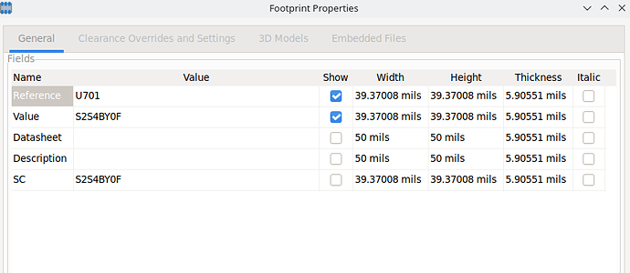

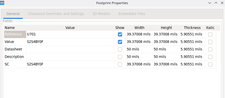

If you double click on a footprint, it brings up its properties.
eg
In there you can see that you can untick the visible tickbox and this will remove the reference designator from the screen.

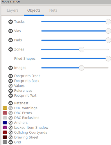

You don’t want the layers tab, you want the objects tab as below:
Deselect the references so they don’t show up any more. You must remember that when creating the Gerbers, though, that hiding them here like this will not stop them appearing on the Gerbers which is why switching them off in the properties is better in your case.

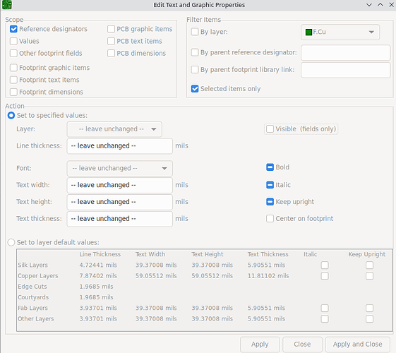

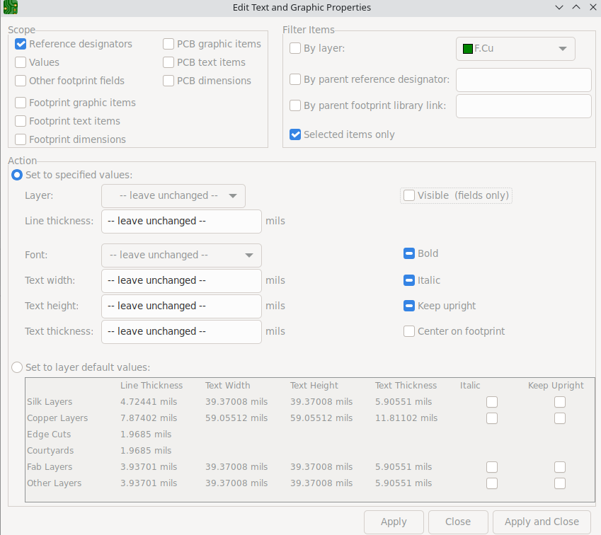

On v9 you can also select all the footprints, then do Edit | Text and Graphic Properties to bring up this window:
Selecting as above will turn off all the ref designators once you hit apply.

That is indeed yet another way to make the references (temporarily) invisible. You can click on the small round “eye” icon to make either a layer or an object (in) visible.

  • De-selecting “show” in Footprint Properties removed some of the “hot mess”, but still left a lot of other symbols.
  • I spent some time on the Objects Tab also, but still couldn’t get what I wanted. I’m aware of the implication for the silkscreen layer, so in the end I just created my own part.

  • Thanks @jmk - I think I’ll order some; at that price one can’t really go wrong. Not a perfect fit for what I was aiming for, but on reflection, they could possibly be “made to work” for some/many things. No worries about the headers; I seem to have accumulated a bazillion of the things from Arduino projects.

This is how it’s looking so far, with the custom part:
I did a quick Gerber export to see if I was on-track - and everything looked as expected.
All I need to do now is create/add pads - decide on the tracks - then learn how to replicate the design across a 100mm x 100mm board (including “mouse-bites”) - the max size from PCBWay for prototype boards at low low low prices.
