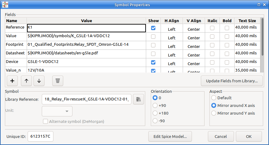

Opening the documentation from within the schematic works. It finds the datasheet in the “downloads” directory where I placed the project.

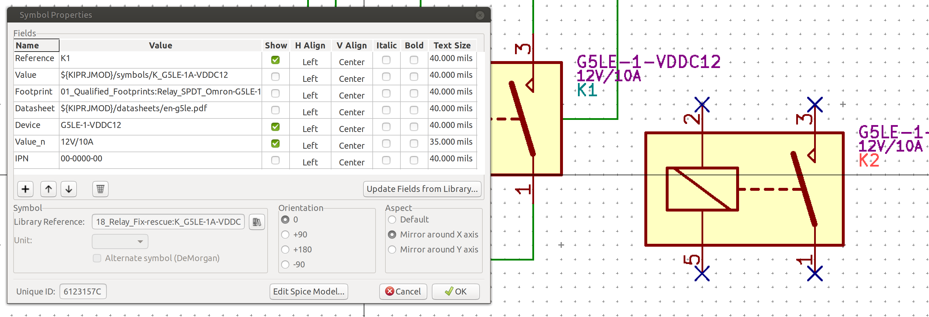

Notice the use of the ${KIPRJMOD} in the schematic Symbol Properties window, and the corresponding link in the PDF reader (Firefox).
Then I closed KiCad, and opened the schematic directly from a file browser in “Standalone mode”.
KiCad can still find the .pdf of the relay, even when there is no active project. So it apparently just uses a relative path from where the schematic is.

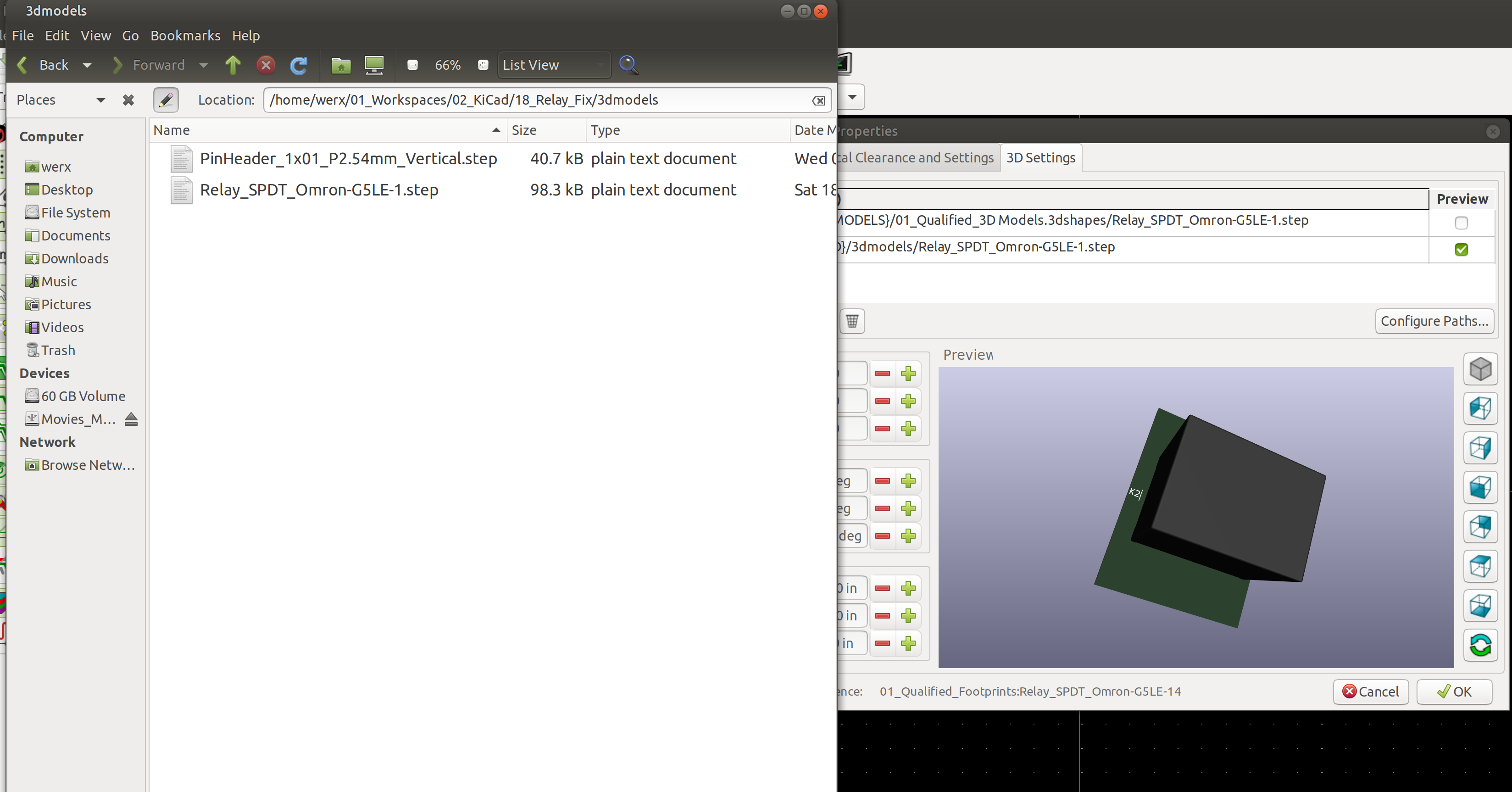

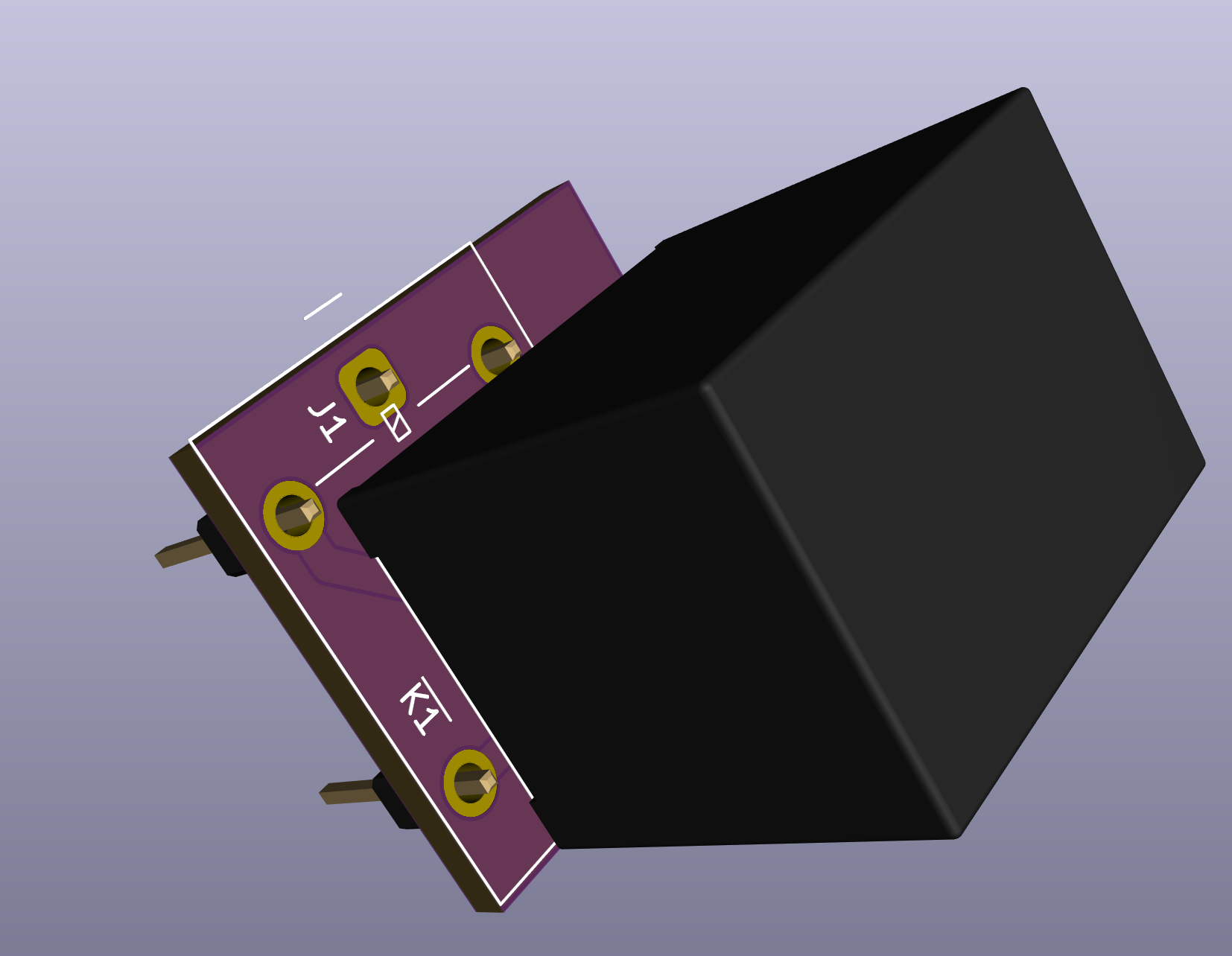

The project has a “3dmodels” directory, however, there is no relay in the 3D-viewer:

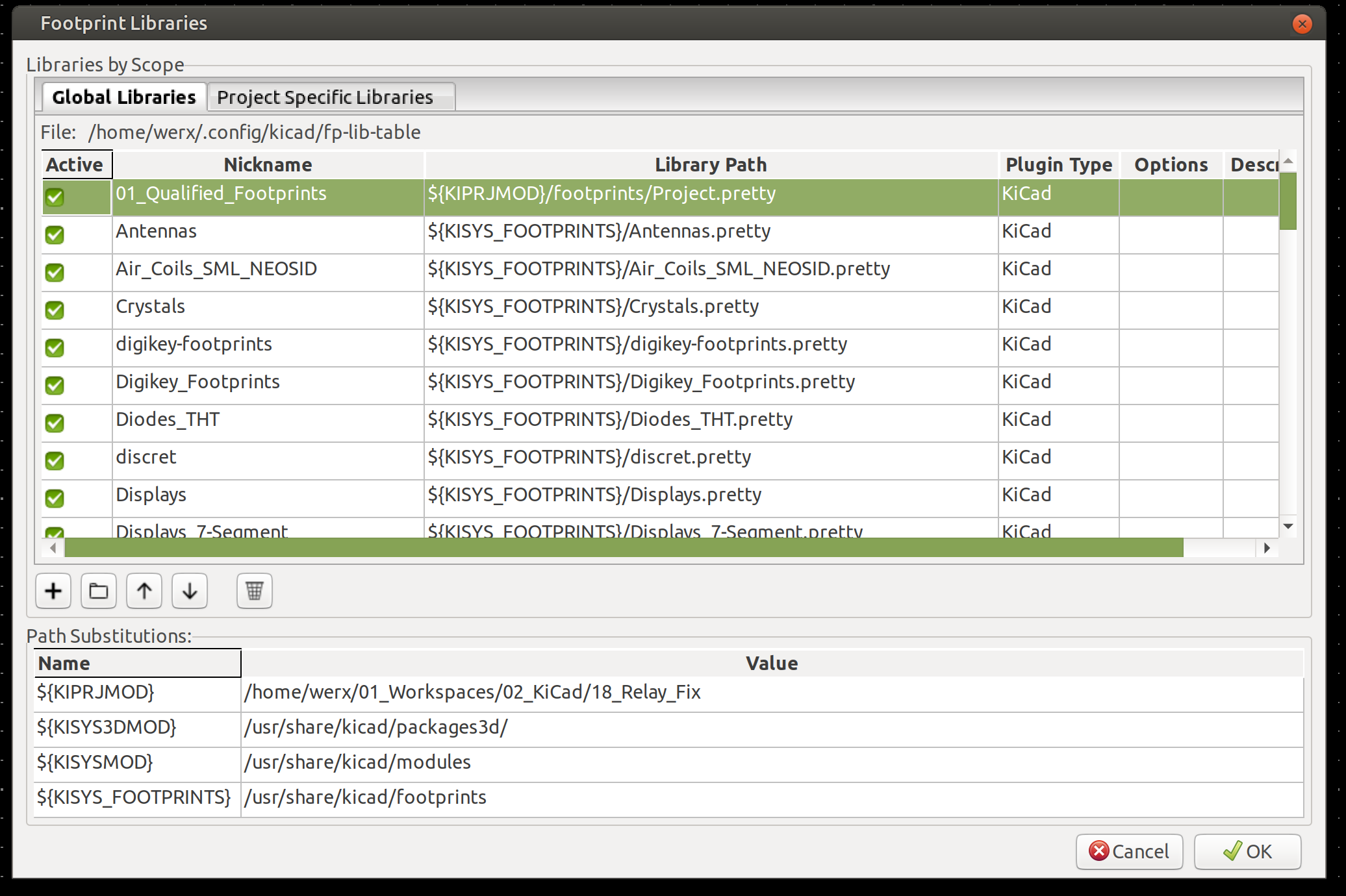

Opening the Footprint Properties of one of the relays in Pcbnew shows a link to: “${KISYS_3DMODELS}/01_Qualified_3D Models.3dshapes/Relay_SPDT_Omron-G5LE-1.step” Which is outside of the project tree.

I don’t know why the 3D Models are not showing up on your end. At first I did have an error that K2 was not assigned 3D Settings to the ${KIPRJMOD}/3dmodels path. However, J1 and K1 were correct; and I sent an earlier version of the project to a friend and the 3D Models were visible on their end.

This image shows some experimentation:
^^^Probably NOT the recommended way to do this, but at the moment it does seem to work. Value has been changed to include the Project Environment Variable.
18_Relay_Fix_21237_1522.zip (1.1 MB)
AFAIKATPIT … As Far As I Know At This Point In Time, this method should work and not break other existing local projects.
