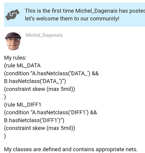

Custom rules in V9.0.3
My rules:
(rule ML_DATA
(condition “A.hasNetclass(‘DATA_’) && B.hasNetclass(‘DATA_’)”)
(constraint skew (max 5mil))
(rule ML_DIFF1
(condition “A.hasNetclass(‘DIFF1’) && B.hasNetclass(‘DIFF1’)”)
My classes are defined and contains appropriate nets.
But they don’t seem to work as they don’t report any warnings.
Can someone explain ?

I added preformatted text format to your rules, otherwise the forum subtly changes some characters.
Not sure I understand …
Nothing to do with your rules per se.
Try copying and pasting back to KiCad the rules from your first post and you see what I mean. The rules don’t work anymore because this forum software messed with some characters. When writing a post you can format your text. Use “preformatted text” for sections of code etc. Then it’s kept intact. It’s also easier to read.

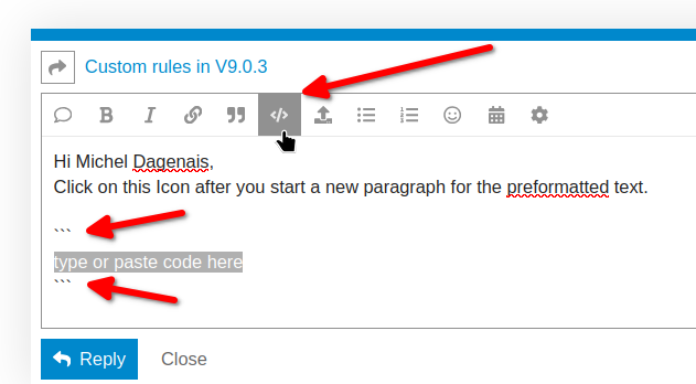

Hi Michel Dagenais,
Click on this Icon after you start a new paragraph for the preformatted text.
type or paste code here
ksnip_20250806-204335
Paste code between the triple back-ticks.

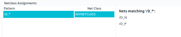

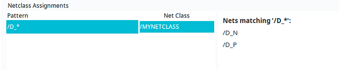

For the class names (which is a string you choose) they would need a slash if you named with a slash (IDK why you’d do that, but I think nothing will stop you:
For net names, e.g. in A.NetName = /DIFF1_P, I think you will still need a slash if the net name has a slash (and KiCad may define that based on the hierarchy)
To put a finer point on it, if you use a local label with the name mynet in the root sheet of your schematic, the resulting net name is /mynet (it is local to the / sheet)
