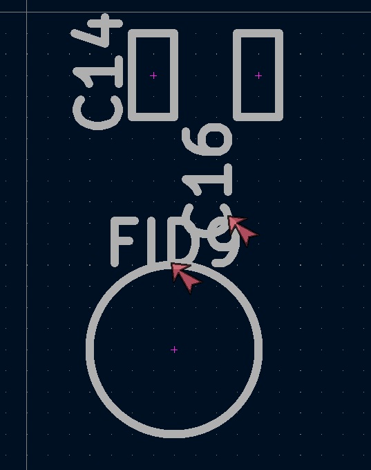

I try to make a custom rule to check the assembly drawing is readable.

Use physical_clearance. clearance is for electrical clearance and fab graphics don’t have electrical connectivity.
Thanks a lot — that is correct. Using physical clearance generates the expected errors.

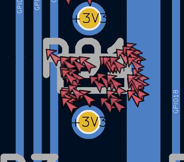

Unfortunately, errors are also caused by text that is not visible. How can the property text.visible be used correctly?

Looks like A.Visible works.
Also you don’t need to check B.Type == Graphic, as this won’t catch text-to-text collisions.
(rule "assembly drawing is readable"
  (layer "F.Fab")
  (constraint physical_clearance(min 0.01mm))
  (condition "A.Type == 'Text' && A.Visible")
But probably the clearance checks should just consider the visibility of the text: DRC: physcial clearance doesn't consider text visbility (#21625) · Issues · KiCad / KiCad Source Code / kicad · GitLab
This also reports collisions involving non-visible text.
I have the impression that you always need A and B for a clearance constraint.
