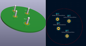

Hi People, I have bit of a problem. So im making a Pcb that needs to have mounting holes in specific spots. They are for measuring another PCB. Only problem is, some of the holes are too close to eachother.
I was wondering, is there a way to make costum pads/mounting holes? The needles need to be soldered onto mounting holes.
And yes, it needs to be like that because im working with very specific Resistances.
I tried some stuff out in Footprint creation, but im unsure how to get the pad inside of the hole.
I attached the pad positions so you can see what am i working with.

I don’t understand what you need. Can you show some example? “Pad inside of the hole” doesn’t make sense because there’s nothing in a hole, there can’t be pad inside hole.
grafik
This is what i mean by “pad inside of the hole” i dont know other description in English for it.
I was thinking about doing something like this, so the outside pads dont touch.
But im having problems with making the hole right as shown in post before.

I have defined my mounting holes by specifying Pad type: ‘NPTH, Mechanical’ and giving ‘Size X’ and ‘Hole size X’ the same values.

I’m guessing this is for a jig with something like pogo pins.

I hope I understand you correctly, below is a screenshot of adding a pad in the Footprint Editor.
I made it a Through-hole pad, because those have plating on the inside, which makes soldering much stronger.
I also added an offset to the pad (related to the hole, which is considered the anchor point of the pad).
It’s probably easiest to make a footprint for just a single test point, and then add as many as you need on the PCB. The pads can be rotated on the PCB if needed. (With an accuracy of 0.1 degree).

I have a Lathe and have made my own long before coming to Kicad so, I never had reason for 3D-model of them. However, I like modeling so, I cooked up one that reflects some I made (on lathe).
Below shows:
• 3D-Model (made using FreeCAD)
• Footprint (made in Kicad using THT and the STEPmodel)
• PCB with the Footprint
If interested, I’ll make a 3D-model for you if provided Dimensions…etc (no cost)
Some screenshots…
3D-STEP Model
Footprint Editor
