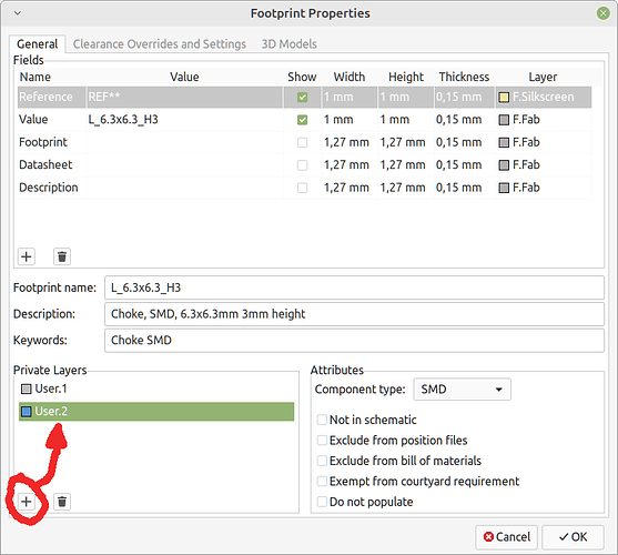

I want a custom layer to represent the outline of an enclosure (to adjust the outline of the PCB to the enclosure and get the mounting holes, connectors, etc. in the right place). I can create that custom layer in the PCB editor, but not in the footprint editor. Is that intended?
I want the enclosure as a footprint so I can re-use it for different projects and I don’t run the risk of accidentally messing up the lines of the enclosure.
My first thought was that this is intentional. In the footprint editor, it’s unknown what extra layers are being used in a project, and therefore a footprint can not use them.
However, apparently you can use: Footprint Editor / File / Footprint Properties / Private Layers, and click on the + to add layers. I have not used this function, I assume these are intended to make notes for footprints only and items on these layers are not visible (or even exist?) when the footprint is placed on the PCB.
