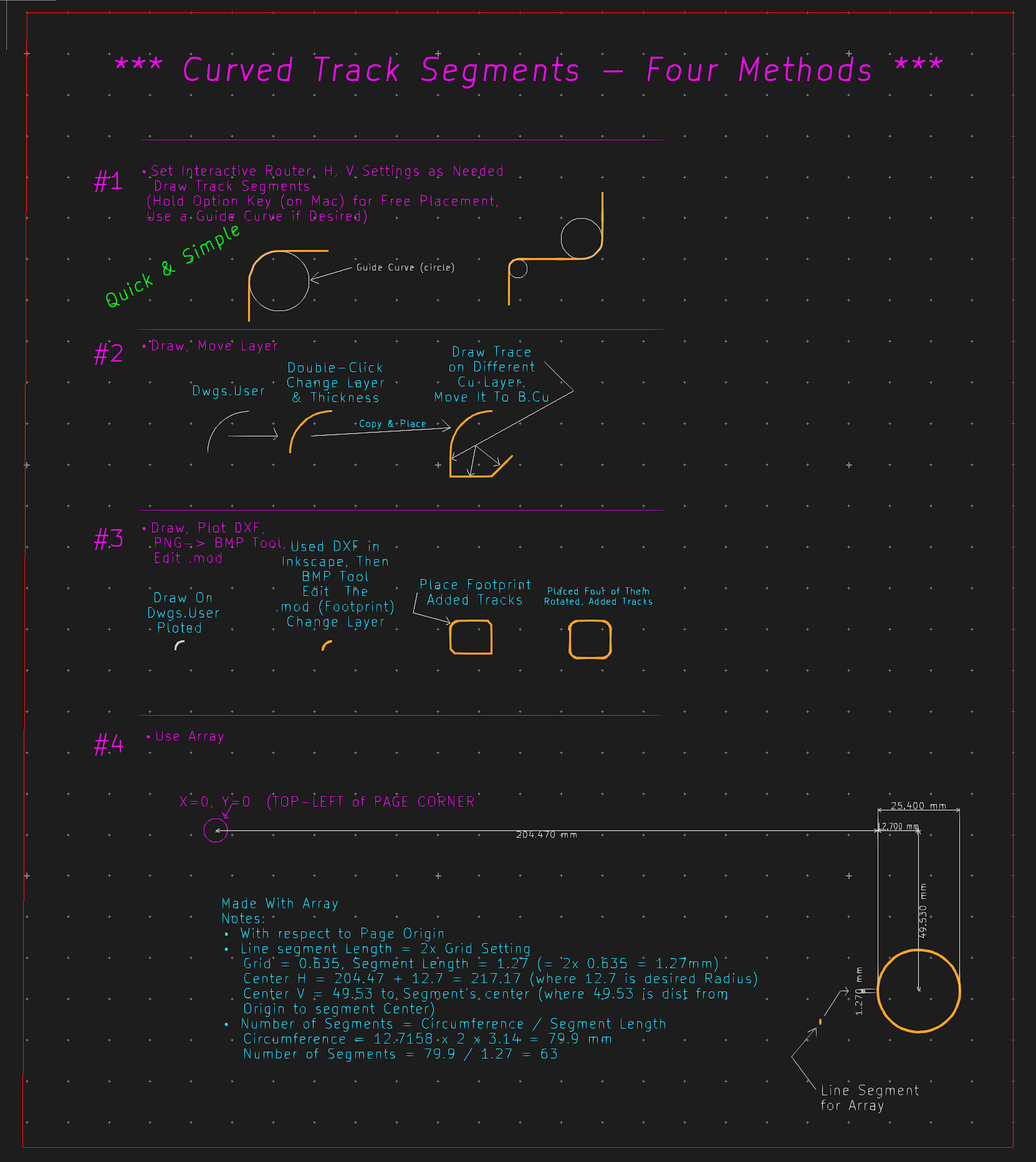

Curved Tracks - Four Methods
Summarizing Some of My Previous Posts on Curved Tracks.

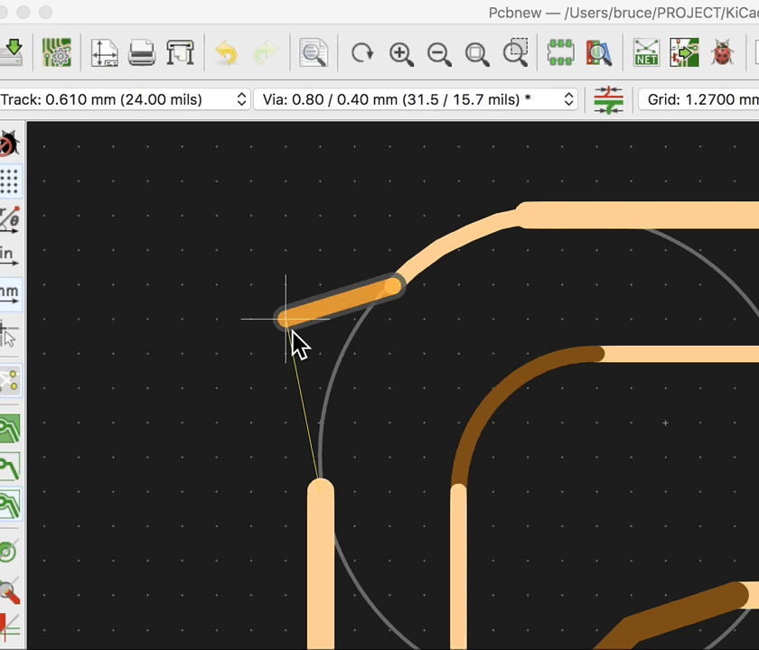

Four Methods… with One Video of Example #1 (off-screen is a Click to change track width)
