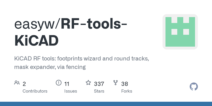

You might find the following set of plugins helpful for curved track, exposed copper RF designs. The current nightly builds (5.99) also allow track rounding without needing a plugin. (Usual warning about nightly builds apply)
