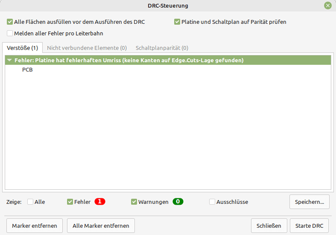

Inspired by the discussion above I checked some behaviour i noticed some times ago. It can be understood, that the DRC cannot find this crossing when all nets have the same name. The behaviour sketched by retiredfeline would be OK, but I didn’t notice this in the past. Therefore I sat up a test project:

The schematic is fully annotated and the footprints are assigned. The schematic is transferred to the PCB using the build-in transfer tool. The sample PCB looks like this:
Running a DRC is only generating one error due to missing outer frame:

Please attach the zipped test project, as it is in the first situation.
“Melden aller Fehler…” Needs to be checked
Yes, without that checked it will stop after the first error for each track (in this case, the clearance error). If you fix the clearance error it will show the shorting error (even without the checkbox checked, as that will now be the first error for that track).
