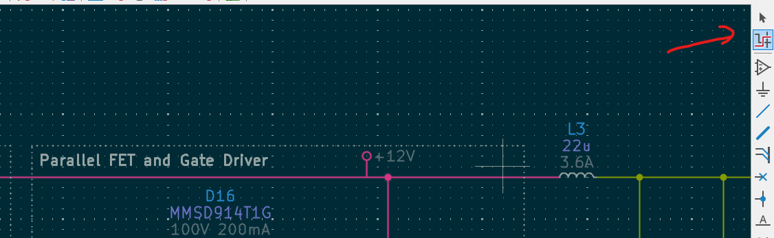

While in PCB, I can Cross Probe any Net, Pin or Component to schematic.
While in Schematic, I can only cross probe Pin or Component to PCB.
I can’t seem to find a way to Cross Probe Net from schematic to PCB.
Am I missing something ?
Are you highlighting the whole net ? not just a segment (use ` to highlight the hole net)
I read the Docs but did not see anything about that “Button”. Thanks.
Highlight a net by marking its wires and net labels with a different color. If the PCB Editor is also open then copper corresponding to the selected net will be highlighted as well. Net highlighting can be cleared by clicking with the highlight tool in an empty space, or by using the Clear Net Highlighting hotkey (~).
