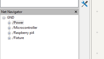

How about in V8 ? In the Schematic turn on the Net Navigator and select a net that’s on several pages . . . GND perhaps ? then use the ` key to “Highlight Net”, the Net Navigator will show you which sheets that net is present on. This also cross probes between the Layout and Schematic.
Thankyou. I was unaware of this feature.
