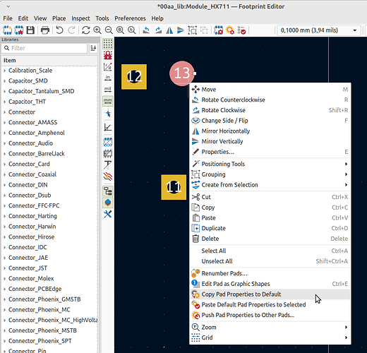

As bidrohini already mentioned. Footprint Editor / Place / Add Pad just places a pad with the “default” properties. And these default properties are modified in some other way. So you can first place a square THT pad, modify it to be a round SMT pad by editing it’s properties. Then right click on the pad and select Copy Pad Properties to Default. After that, all new pads you place will be round SMT pads until the default is changed again to something else.
In a similar way, bulk editing of an already existing selection of pads can be done with Paste Default Pad Properties to Selected.
