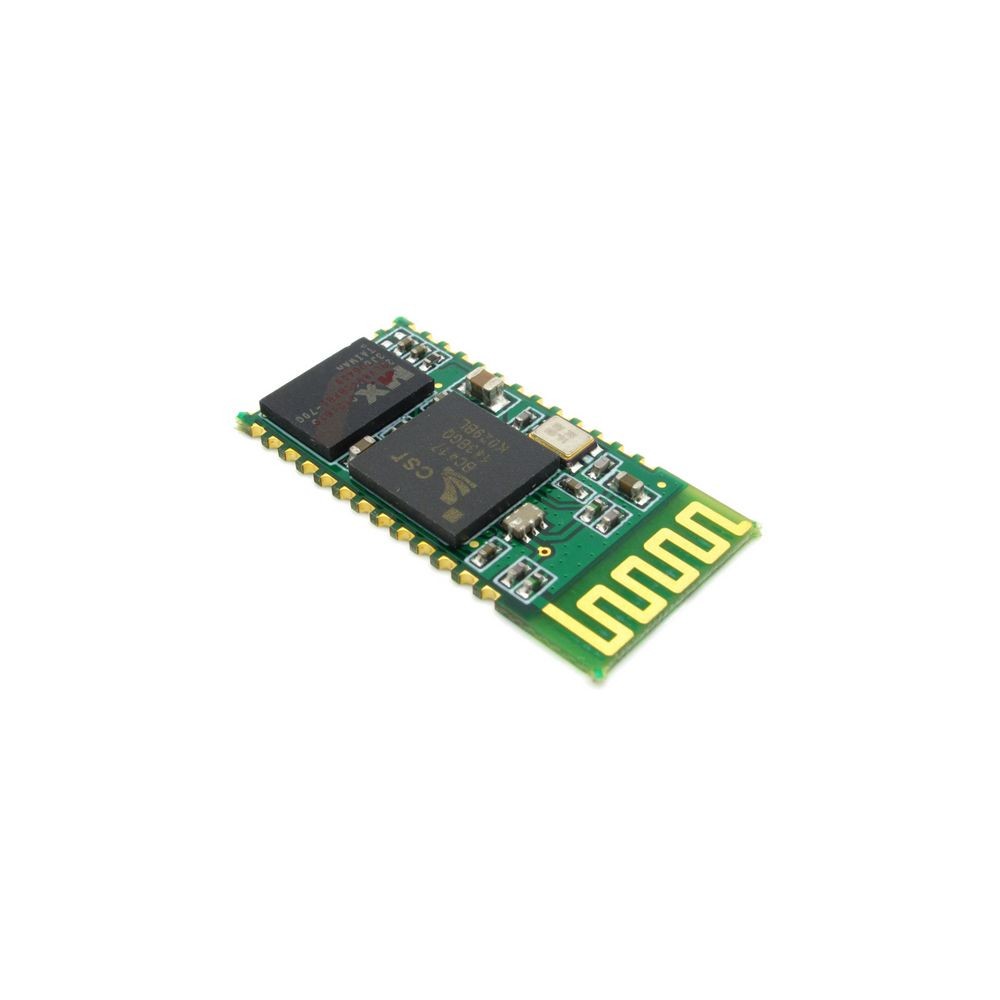

Hello everyone!
I would like to design and manufacture a tiny board that can be solderable. I’m thinking in something similar to HC-05 and ESP boards that have an outline with what seems to be cut connector holes.
I was wondering what is the proper way to achieve something similar to that. Any ideas?
you may have a look at here
and a kicad project with these connectors
So it seems this is called castellation and it is done by placing connectors that are later milled. I didn’t expect this because I imagined that the routing would rip the copper out of the PCB.
I will ask if this could be done by the people I usually order PCBs to.
