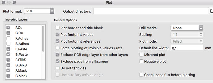

Can KiCAD produce a negative (Blk-Wht reversed) printout of a PCB layout ?
Need this to use as a mask for a backlit panel legends faceplate. Black background with white (clear) characters.
Is there a PCB layer specifically designed for this purpose ?

You can plot any of the layers to pdf (or several other formats) from the ‘File > Plot’ menu. The pdf output has an option for ‘negative plot’ which should achieve what you want.
