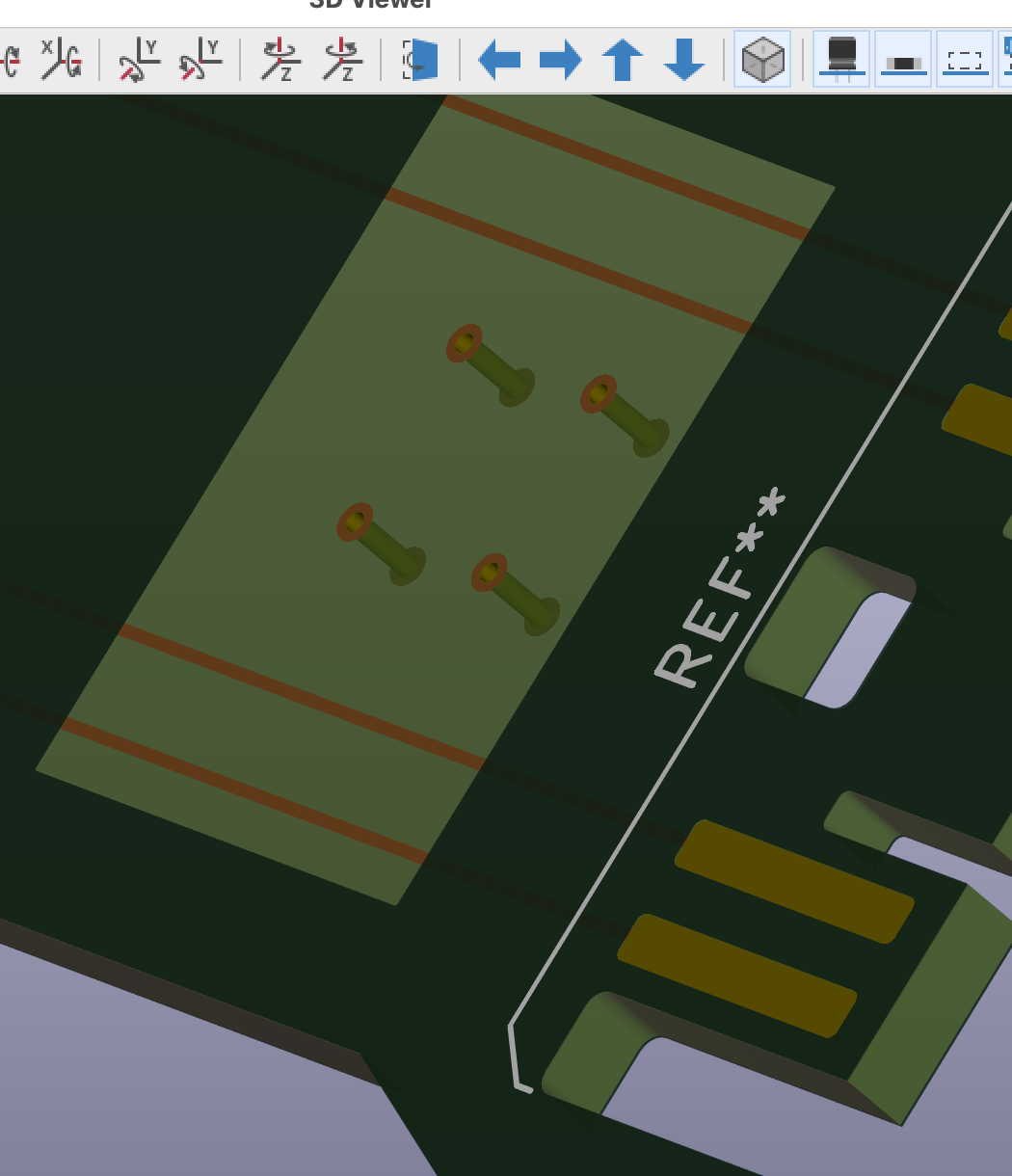

Hi, I am creating a flex pcb layout with a layer to indicate the area where a stiffener should be applied. I’m using the User.1 layer renamed as Top Stiffener. According to JLCPCB, they say to indicate the area with a filled shape, so I created a non-copper zone with solid fill. I would like to have some holes in the stiffener, but not sure how to accomplish this. Is there a way to have a keepout area that effects the non-copper zone? I have vias where I want the holes, but they do not seem to effect the User.1 layer. What is the best way to accomplish this? Using KiCad 7.0.6

The last time I had a Flex PCB made was before all this new technology arrived so, reading this Post and it’s leaving me a bit unclear on just what OP wants, I decided to jimmy-up something from previous playing-around work and Ask JCLPCB about how they want Stiffener’s indicated in Kicad.

Now, to the Posted PCB question - I’m not clear on what you want but, perhaps it’s something like this screenshot showing a Mask-Zone with Vias…
And, in v7, you can Right-Click a drawn shape and convert/set it to a Zone, DRC-Rule…

Thanks for all the replies. I just realized that the via will likely get filled, so I need to change that to a hole. So I see I’ll need to put a single hole footprint where I want to have a hole. And I still want that hole to go through the stiffener if possible and maybe slightly bigger, which will require one of the above solutions. I think this is common when using through hole components with a stiffener and flex pcb, although my intention is to have a hole for sewing to fabric. I’m not sure if JLCPCB will support holes like this, but I’ll find out.
In case it hadn’t dawned on you… Can either use a ‘Hole’ related footprint or, simply Draw a Hole in the Edge-Cut layer. It should populate through all Layers in fabrication.
You can ensure it happens by Drawing a Circle at location and making a Note on the Stiffener layer using Text…
Here’s a Hole in Edge-Cut layer
Ok, thanks for the tip. I can see a hole in the edge cut layer would be easiest for my situation. Although a site that mentioned putting holes in the stiffener for through hole components suggested making the hole in the stiffener slightly bigger to account for slight mis-alignment, but yeah in my case it wouldn’t really matter. I asked JLCPCB about holes in the stiffener, and they said it’s fine to put the hole in the filled shape on the stiffener layer. I’ve ordered the flex circuit, so I’ll see how it comes out.
