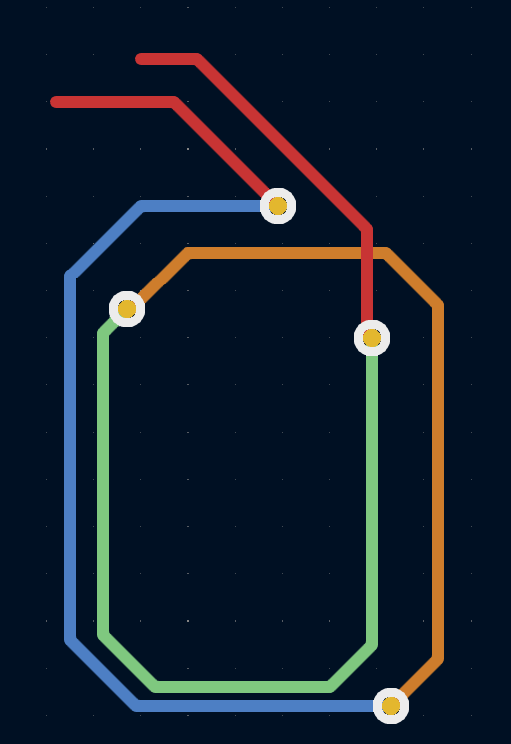

@hannahannah I’ve done something like this before for NFC antennas. There are two ways to do it:
  1. Make it a footprint. This is a bit of a pain at the moment because it’s hard to place traces on inner layers - you have to explicitly set the layer of some graphic elements and the footprint editor does not provide a convenient way to do that. I’d recommend against it for this reason as it might require editing the footprint in an external tool.
  2. Don’t make a footprint. Instead, draw your traces directly on the board. On the schematic, you have a short circuit (direct connection) where the coils are. This is important. You don’t need anything else on the schematic. In the board layout, go to File->Board Setup->Physical Stackup and select 4 layers. Put in and connect all the other stuff on the board except the coil, lay it out so you have space for your coils left on the board. Then, go to Route->Interactive Router Settings and disable “remove redundant tracks”. Point your mouse pointer to one of the pads that the coil is connected to, and press X. The trace will start from whichever layer the pad is on. Take it off the pad, press V, click to place the via and then press - (the minus key) until you are on the layer you want your first coil layer to be. Draw your first coil layer with the mouse, then press V again to place a via. Click to place the via, and then press - again to get to the layer you want the second layer of coil. Continue this way until you get to your final layer. Once you have everything in, you can adjust exact trace positions by switching to a layer (with the +/- keys) and then pointing to a trace and pressing D to drag it (click to fix). When everything is exactly as you want it, select all the traces, right-click, and select Locking->Lock. Now these traces cannot be modified unless you unlock them. You can then continue connecting things.
I drew a simple example using this technique to demonstrate it.
If you want rounded traces, select the tracks (but not the vias) using the selection filter, right click, and select “fillet traces”. Note that you have to do this before locking the traces (or unlock them first).
