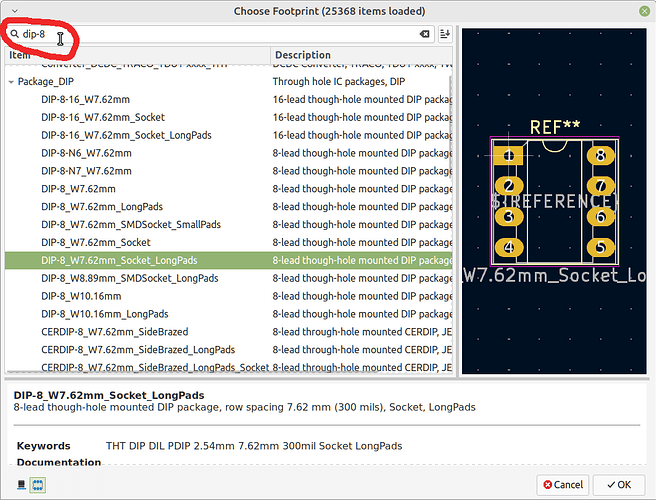

I can not find DIP sockets in the list of footprints (seems that this would be a common part). Am I going to have to make any DIP socket footprints I need myself or is there some device with an 8-pin DIP footprint that I could use?
KiCad has libraries both for schematic symbols and for PCB footprints. Partially those are separate, but some of the schematic symbols have a pre-definded / default footprint. But regardless of that, any footprint can be associated with any schematic symbol.
When I search for “DIP-8” then I see over 40 footprints. Do you have the default libraries installed at all?
I opened up the footprint editor, searched for "DIP socket"and the result was footprints for DIP-4 to DIP-64 in normal and longpad versions and various row spacings.

But there are no DIP sockets below DIP 14. And there is a difference between a DIP-8 socket and a DIP-8 footprint.

But if you are looking in the lib “Socket”, you will miss 8 pin sockets.

Okay folks, In the footprint editor I did find sockets, even a DIP-8 socket that I can use. However, when I go to “Assign Footprints” it lists the parts by reference designators and so there is no XAR1 ref des as of now. So I placed another LM386 IC on the schematic, changed the ref des from U? to XAR1, went to “Assign Footprints” and assigned the DIP-8 socket. Now on the schematic how do I render the graphic symbol invisible, just leaving the ref des to move around and place by the AR1 ref des? Or do you have other steps to follow to accomplish this? Thank you.
