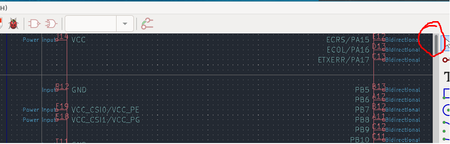

When I create a complex component symbol with 441 pin,
i cannot see complete symbol by scroll top right as i emontion after zooming in the symbol:
i use a 14inch laptop run Fedora 32, the kicad version is V5.1.6, is there any solution?

OP seems to indicates that his vertical scroll bar is all the way up but his IC top line (possibly with pin connections) is not showing. I.e. he cannot scroll further up to see his entire symbol.
Thats what i make of it anyway.
I did see the circle around the scroll bar and that the top of the symbol is off-screen, but did not connect those 2.

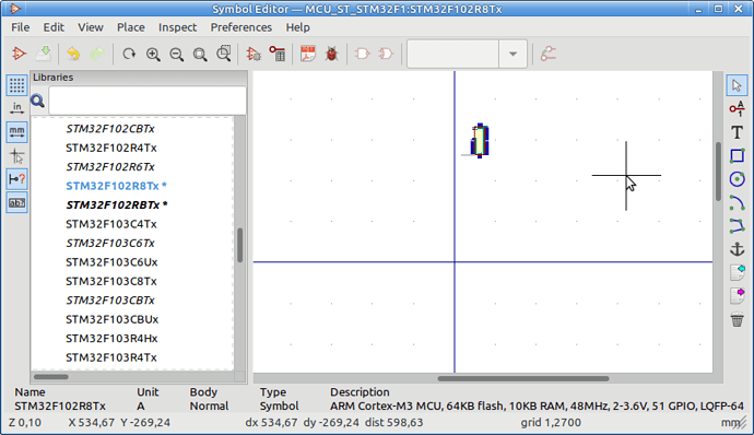

I’ve managed to reproduce this.

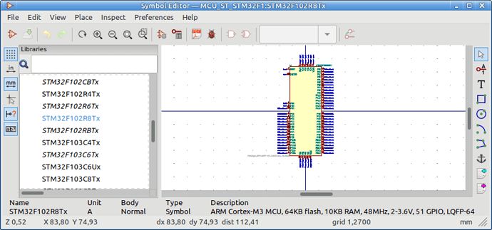

Schematic Symbols should always be designed around the origin of the symbol.
In the Symbol editor you see a big cross spanning the screen, this is the origin of the symbol.
If you drag a box around al graphical items and move them far away from the origin as in the 2nd screenshot, then you get this weird behavior when zooming in.
This seems to be the same bug as I’ve encountered in Eeschema a few times. I use the area outside of the “paper” layout a lot for temporary notes or for “storage” copies of part of the schematic, and I’ve noticed that if you put those parts too far away from the “paper area” you can not zoom into it anymore.

yeah , i putting all the 441 pin in one symbol,when i edit this symbol, i encount this issue, i want scroll the top the symbol , but i failed, i can not see the top of the symol, it stuck.
