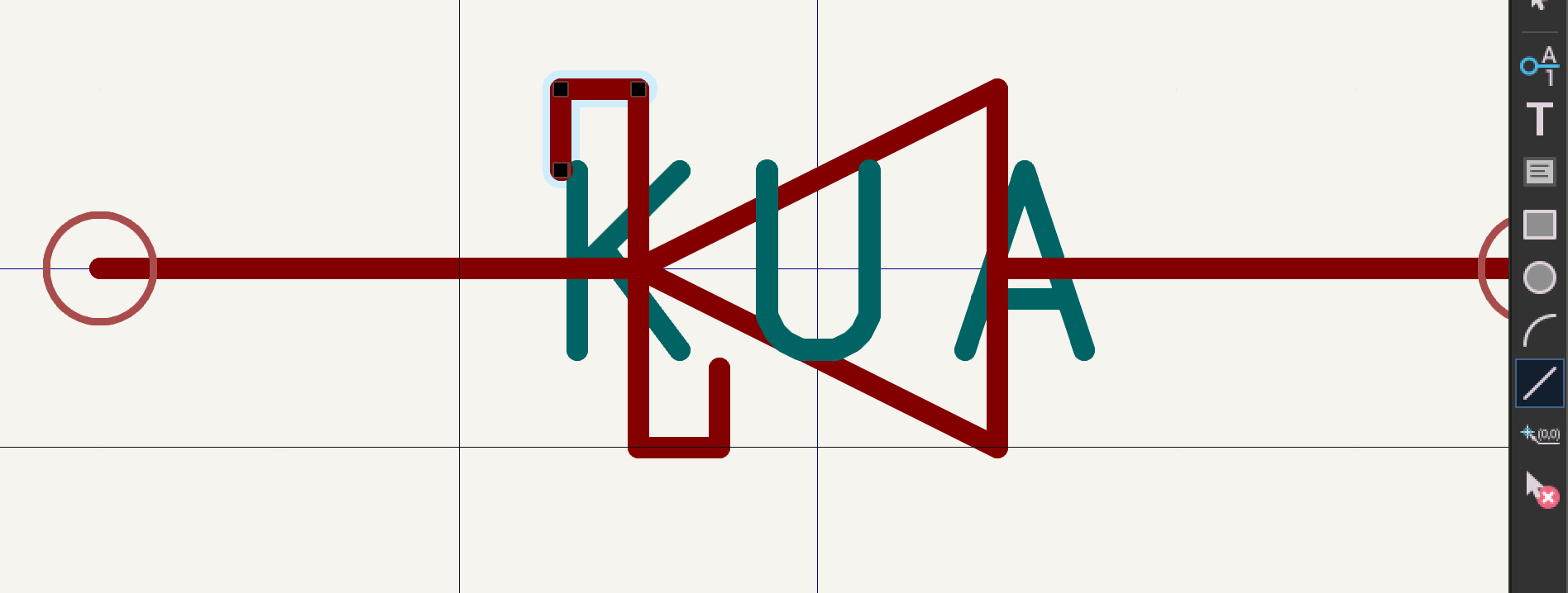

I created a schottky diode symbol like this:
Don’t remember how I managed to add the “A” and “K” and comparing it with other symbols of that class of devices they don’t carry the A or K. How do I get rid of the letters A,K?

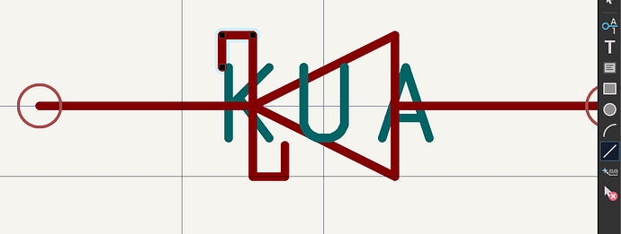

Those texts are the “values” of the pins. You can set the visibility of these with: Symbol Editor / File / Symbol Properties and then in the Pin Text Options section, which has check boxes for Show pin number and Show pin name.
Thanks. Found it. Rightklick on pin (circle), enter “Properties”, blank out pin name.
Instead of blanking out the pin name, you can also only make the text invisible. Auto generated net names put this pin name in the net name, and having an extra indication to where the anode and cathode is in a diode can help with preventing simple mistake.
