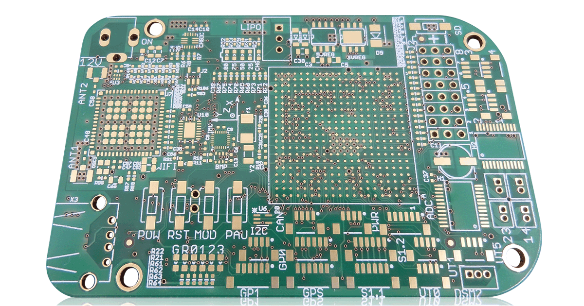

This will also be affected by the board’s finish that you specify from the manufacturer. The cheaper HASL may leave small “puddles” of solder on the edges of some pads, but since this melts during the soldering process this is usually not a problem for tabs and heatskins. Even IC packages with pads on the bottom of the package often aren’t adversely affected by this. The ENIG process provides an exceptionally flat surface, usually required for BGA packages, LLC packages, or fine pitch packages. This finish detail isn’t normally specified in the Gerbers, rather you usually have to choose this specification on your job order, or a special job file submitted along with the Gerbers. Check with your manufacturer to find how they want you to communicate this requirement for your order.

Thanks for this useful information! Again, this is something I had never heard of before. I had always thought that a tinned finish was a tinned finish, and was unaware that there was more than one type of tinned finish. For the board that is supposed to be mounted flat against a heatsink, would it be necessary to specify ENIG? Or if HASL is used, would it be sufficient to make the B.Cu groundplane surface flat by placing a piece of fine grit sandpaper on a piece of glass, and sanding the board in a figure-8 pattern? (Obviously the pressure against the board should be distrubuted as evenly as possible, and the process cannot be done aggressively. I also plan to make the mounting surface of the heatsink flat by this same method.) I would imagine that ENIG is more expensive. If it is recommended to use ENIG for the board that will mount to a heatsink (rather than using HASL and sanding it flat), is it possible to specify ENIG on the groundplane surface on the rear of the board, and HASL on the front of the board?
