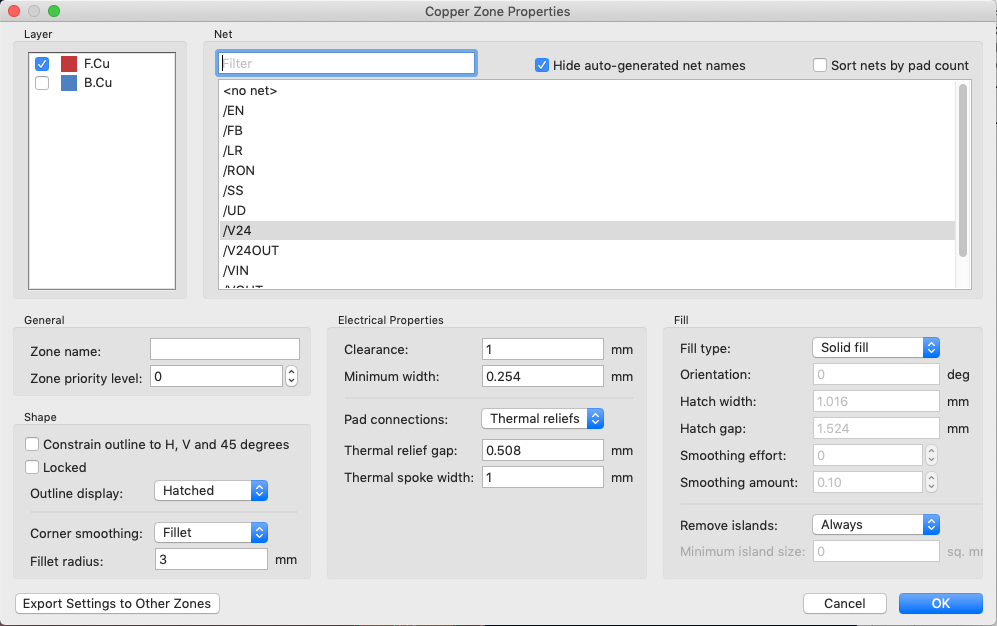

Copper zone corner smoothing behaviour changed in V6?
I noticed different behaviour between v5 and v6 when doing corner smoothing in copper zones.
This is how a zone looks when loaded into v6.0.4. This zone was created in some version of v5.
After pressing ‘B’ to refill the zones, it looks like this:
So the inside corners are no longer smoothed. These are my settings for this zone:
Is this a bug or am I missing some setting?
Thanks,
Ben
Uncheck File → Board Setup… → Design Rules → Constraints → [x] Allow fillets outside zone outline?
Yes, that fixed it! Thanks so much for the quick answer.
